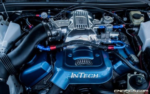

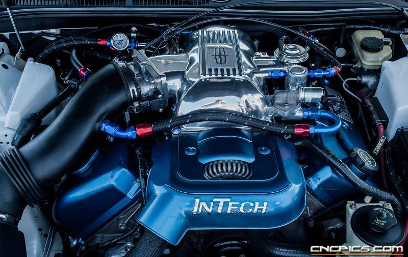

I know some may have seen the photo, but, this is more of a general post. For those that know, I did my Cobra intake conversion/swap in one 8 hour shot - drove the car to my parents one morning, and drove it home that evening on the new intake manifold.
I've written a how-to (mostly complete) on how I did the swap, and I've included a large list of all of the part numbers that I had used.
