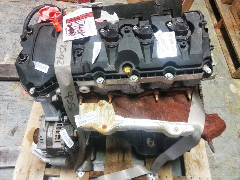

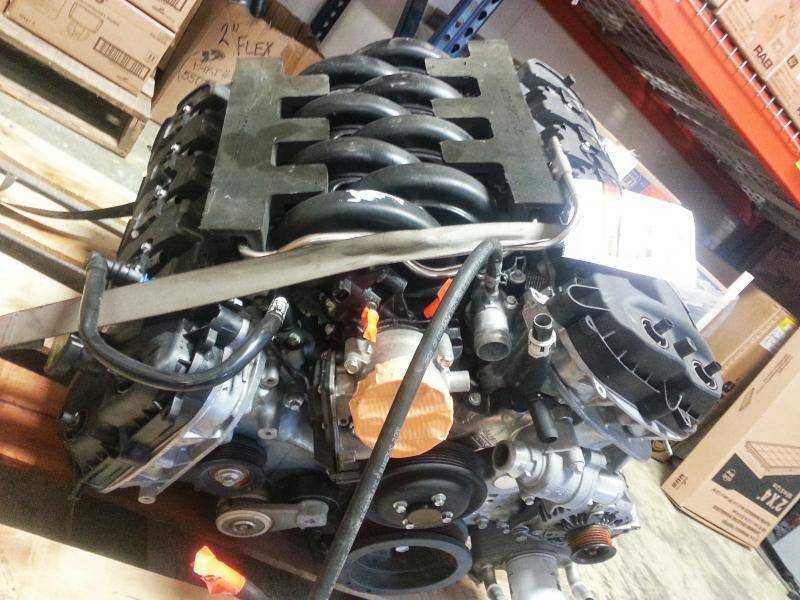

Proof that this was a Junk yard pull out of a 2011 F-150 truck,the intake is black on the trucks and the runners are tuned differently than the Mustang,no good for higher RPM's,Bad enough it starts to fall off @5800...The Mustangs are cheap on Ebay.$50-150,I got mine for $60 shipped,and i already know what some of yall are thinking,Boss ? Waste of time until you do the big cams,CIA,90mm TB,but even then my tunner thinks it's a waste $$ these cars need low end torque and the Boss intake takes that away...

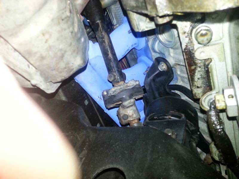

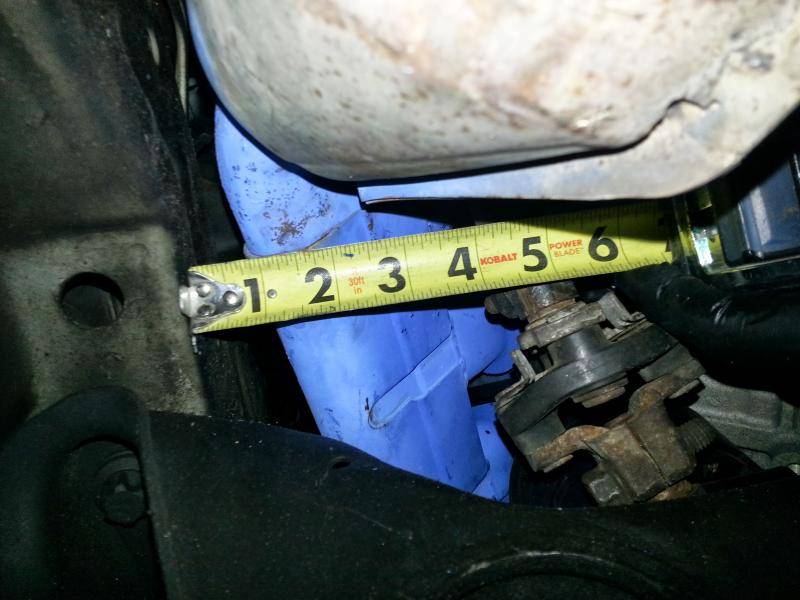

Below are photos we started taking of the first of what I knew right off the bat was going to be a problem,the steering input shaft
and frame clearances..

oh ya..but it is still an expensive swap.$8k min with all the other parts,tuning and tyranny torque converter upgrade,the stock 4R70W can't handle the kind of power i'm making..you gotta go with Trans go reprogram race kit,deep pan and RedLine race clutch packs...i'm not into the T-56 swaps in the Marks,just not for me as much as I race...there are some pretty important valve train differences between the Truck,Mustang and Boss variants that I'll post at some point,most important is the valves..And the $8k is parts alone being frugal on buying and doing it all your self minus Long Tube Headers which is another $1250+ min..We just bought a set of used Craigslist stock GT headers and just modified the driver's side to clear the Steering shaft...this is by no means a straight forward swap,but I did the leg work first so shouldn't be near as bad with my info just a lot of patients and money cause all the little stuff adds up really quick too..LOL

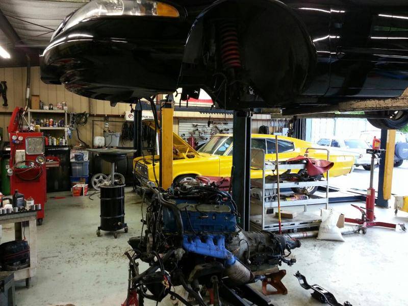

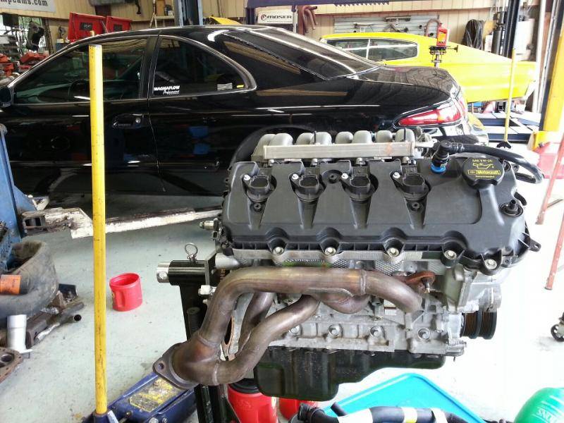

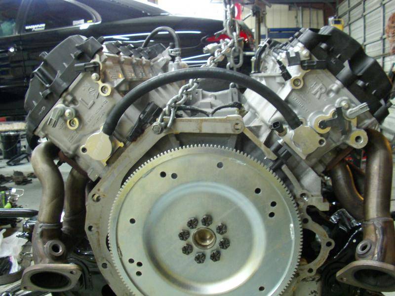

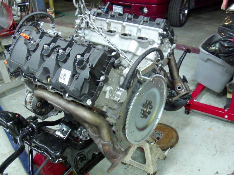

The Beginning,pulling old faithful out..Putting on the GT intake,headers,Hayes SFI 8 Bolt flex plate from a 03/04 Cobra,yes the truck has a forged crank..And probably the most important bolt on before the engine ever get installed is MMR's head cooling mod kit that ties the heads together in the back..#8 like all MOD motors in the past is the hottest of all due to the water passage dead heads around #8 and has nowhere else to go..The mod lets it flow though to #4 creating 360 degs of flow..On my PLX gauges I read OBD signalsfor temp,fuel trims volt etc. Coyote has InfraRed water temp sensors,so it is reading cylinder head temp,not water temp and mine averages 175-190 deg at idle or scooting around town running 90% water & Redline water wetter...The Mustangs are notorious for blowing #8 with only an aggressive tune driving around town,trust me it's well worth the $199.00 or so it costs... part# 455478 http://www.modularmotorsportsracing.com/2011CM2.jpg

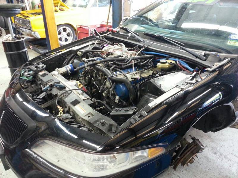

I did this build back in May Mark007..lol..I'm now on a winter tear down with her preparing for a 76mm turbo set up for phase 2..
