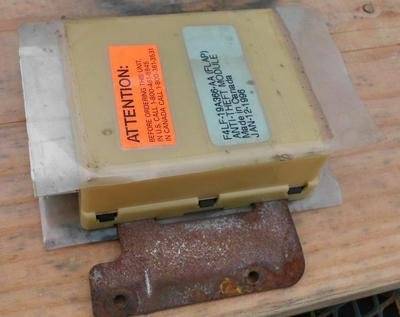

Should look like this, just unplug it.
Try unlocking the driver side door with the key - I thought I read that is supposed to disable to alarm.
I've been unplugging the wrong modules. From what I've found i have been unplugging the lighting module and the air suspension module (of course that did not work). Where is my anti theft unit located?
The alarm module is located behind right side of dash near kick panel.
The Op has a 2nd gen, therefore the anti theft is built into the scil module. They are located in about the same place, but you can't just unplug the scil. The link slowmkviii put up tells how to relearn the scil.
