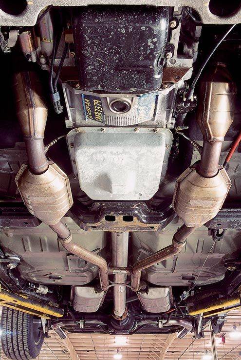

Exhaust leaves via a 2-1/2-inch Faurencia true-dual exhaust with 2-1/4-inch tailpipes and polished 3-1/2-inch Meg's tips.
Read more: http://www.hotrod.com/featuredvehicles/47438_2003_mercury_marauder/#ixzz1bBnPEjU1
I would start by removing the mufflers and replacing them with some long, thick walled tips (hidden for the most part, please!) and see what you think. You will have a hard time replicating the note exactly as the length of pipe and factory muffler design has a lot to do with it.
