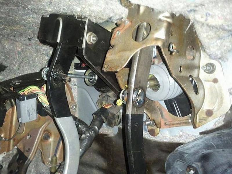

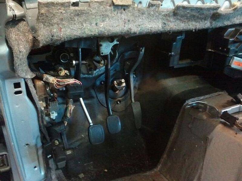

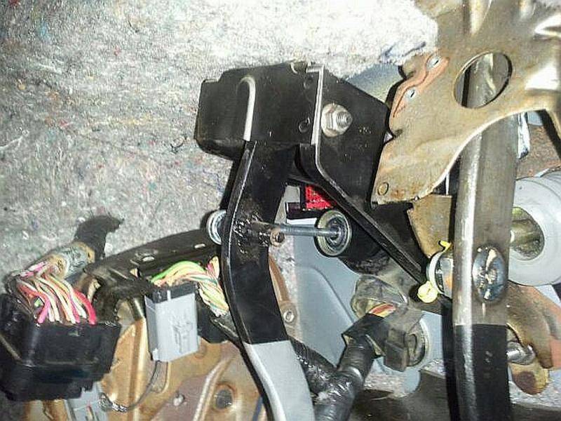

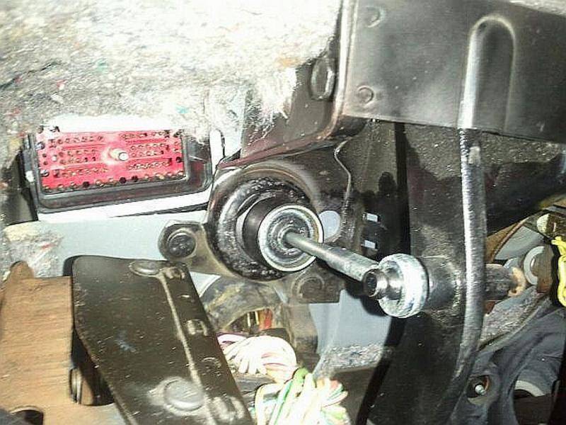

Hello everyone, I had the clutch pedal set up installed in my 96 by RJ performance in sharpsburg Georgia. I had the dash and column, console etc out fixing the air conditioning and figured it was now or never so loaded it up on a trailer and carried it down there from north Georgia. The guy that runs and owns this shop is a Ford only guy by the name of Jason. I am happy as a tornado in a trailer park over the work and the price was good, not to mention the help with what lays ahead putting a 5 speed in the car. I don't have a clue what it takes to load up a picture but if someone wants to see the finished set up I can send a pick to you.

Please....send pics here and I'll post them for you if you don't know how!
HANG THE EXPENSE is having troubles posting pics and sent a pic of his clutch assembly to my e-mail. So here it is. Looks good!

Thanks for posting the pic Dan.The fun begins putting all the dash back in and not having anything left over.
Yes,that is correct.The fun will be repositioning the ecm or whatever its called away from the clutch pedal area and eliminate the a/c vent below the column.Its a learning process for sure.
Yes....received and posted! Had to clean them up and sharped a bit, but here they are. Good job btw!
