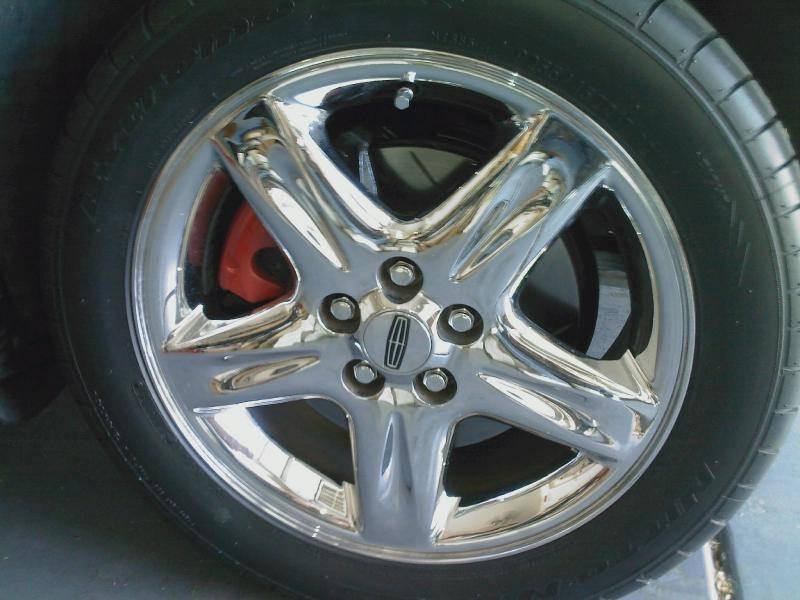

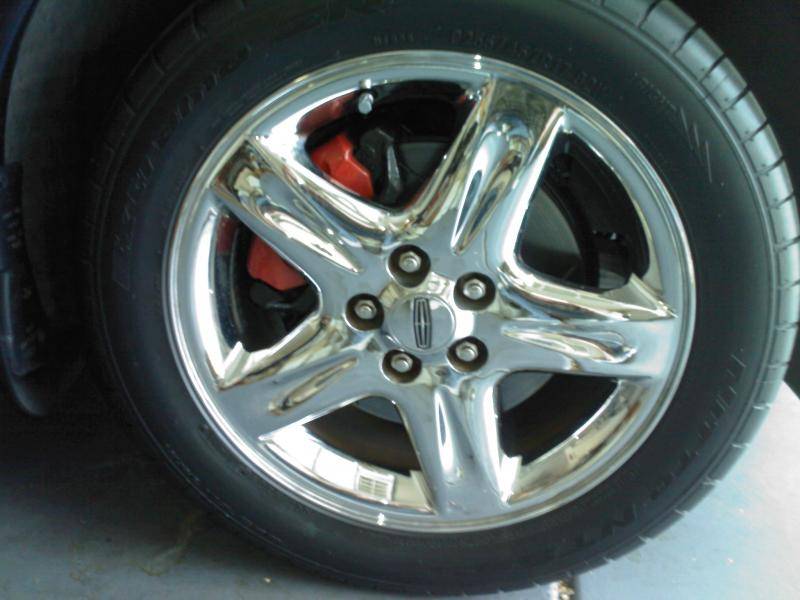

Before/After pics with old/new lug nuts.
