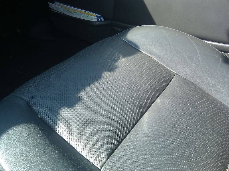

1st gens had a rare option to have a basket weave pattern down the center section of the seat
like these
like these
It was the '02 Premium. Basically a conglomerate of sport and non-sport pieces.
