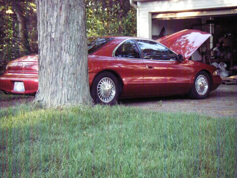

Original AAS kit.
I can't stick a full finger in between the tire and fender up front, the rear can fit a finger w/ 1/2 tank or less. The rear springs are using Prothane isolators top and bottom with the solid billet upper mount. Standard isolators made the rear sag like a late 90's Taurus.
Iirc, the fronts measured 26" ground to fender and the rear was 26.5" w/ the prothanes and stock wheel/tire combo.
It handles horribly.

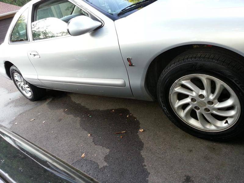

Lowered on my old 19's- I had a trunk full so the rear is a little low.

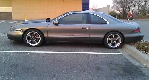

Here's a recent photo of The Mark. Trunk was full of luggage at the time of this photo. 1 1/2" lowered American Air coil springs & whatever shocks come with the kit. I don't recommend any lower on coils than this unless you do not mind tearing up the underside. The way mine sits now has me holding my breath frequently. :)
I'll also add that when I had the 19's on I had to modify the inner fender linings, pretty much cut the center out connecting the two pieces. When hitting gnarly dips they would dig into the linings and it eventually ripped one of them off.
Lownslo, that is the look I'm going for. I cut 1.5 coils off my V8 T bird springs Sunday and its close to being there. Looks pretty good, still rides nice, not bouncing all over the place.
