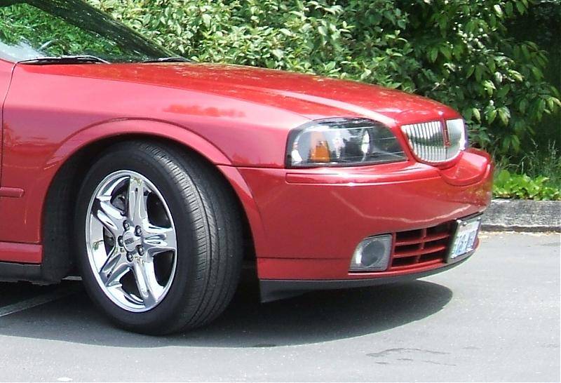

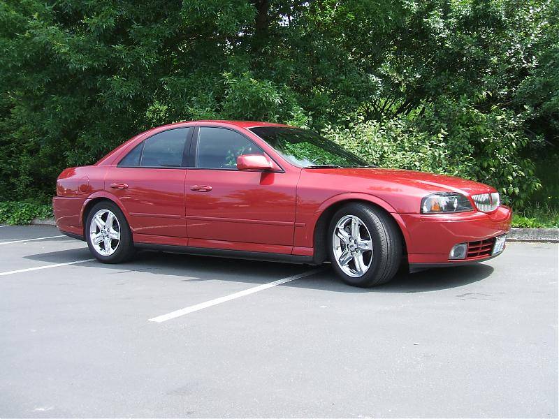

Here's the Pro-Kit by Eibach, but with stock wheels. Just did 'em yesterday..
That does look very good!
But with a car like Broke LS's, I think Id rather it beeing sitting on the ground..
Nice job NYC!

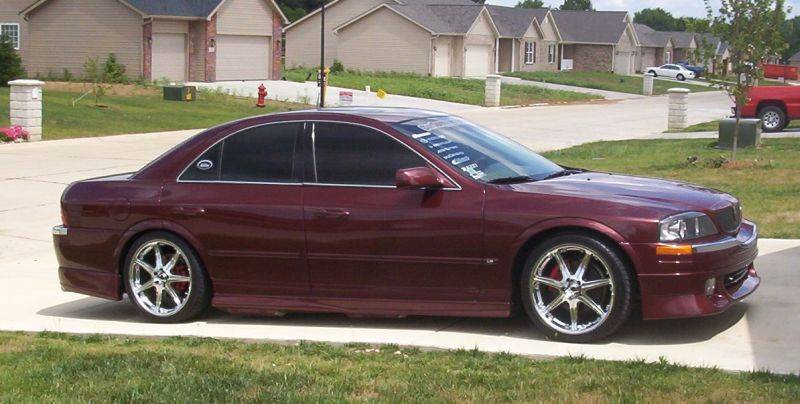

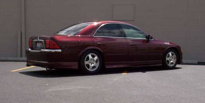

I used the Eibach pro-kit and got a 1.75" drop.
First picture was in the stock 16" rims.
Second picture is with the 19" Konigs.
What size tire is that Rollin? It still looks like it has a big side wall and there is more than enough room between the tire and fender. I thought Eibachs didnt come that low?
Looks like a good drop.
So even when the average 20" setup is the same "OD" as the factory 17" it will rub and the factory set up don't?
I don't know they must have been running huge sidewalls and or bad shocks/struts...or maybe its cause they have pounds upon pounds of stereo equipment in the trunk???
I am running Dunlop Dizerra 101 245/35/19's mounted on 19" Konig Prophets chrome. I measured the ride height before and after the spring swap. It dropped it 1.75" inches. I NEVER rub.:D I am looking into buying new shocks and struts for it this summer.
