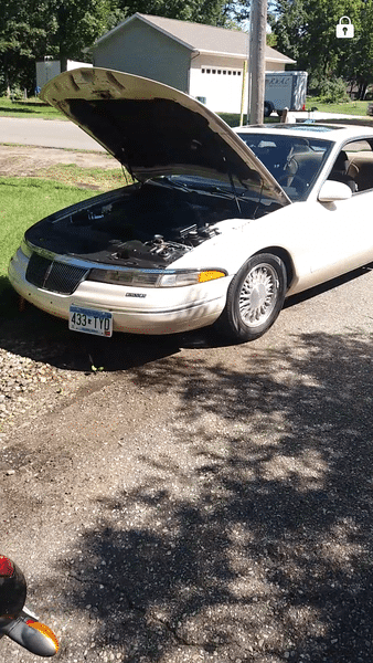

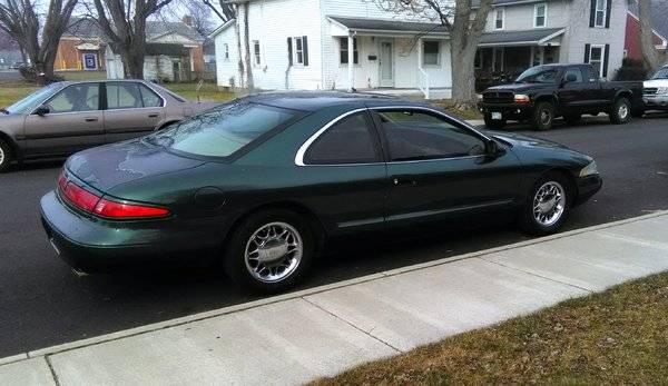

I've been thinking about lowering my Mark VIII even more (.5" drop on it now). But I plan on getting something AWD soon, so I don't want to spend a lot of dough modifying my current car. So I was wondering; I know you can adjust the sensors so the bags will inflate creating a lower ride height. But I've included 2 pictures of my car this summer, being the height I want for normal driving (for some reason it decided thats how it was going to air-up for a week). What I'm after is the ride height of the front, all the way around. Is it possible for me to adjust sensors to achieve this amount of low? I'm aware its more work for the bags, and compressor.

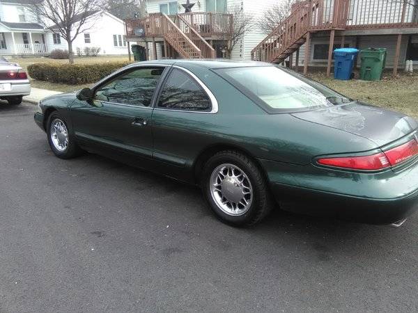

Redrilled the lower mounting bolt holes up front and cut the rear air bags along with moving the sensors, just did this yesterday and IL still playing with it but it's close. Might drop the rear another 1/2" and the best part is this was 100% free. Just a afternoon of my time
How much lower did you drill the hole fore the sensor on the front ? Look that you have found the right level that I like. Mine is very much to high

That height wasn't all my doing; due to the car being as old as it is. I believe the valves don't close properly anymore, so it leaks very, very slightly throughout the night. I went to go drive, and that's how it looked. And it looked damn good. As far as lowering the mounting thing, I didn't do that. The original bolt/ball thing broke, so I just got a regular bolt, and a locking nut, put it through the hole on the sensor, and pushed it to the very top of the bracket's opening. And that's how it is on both sides. I have a bonus question if anyone answer; Would it be possible to swap springs from say, a Mustang or Thunderbird? As a coil-conversion?
