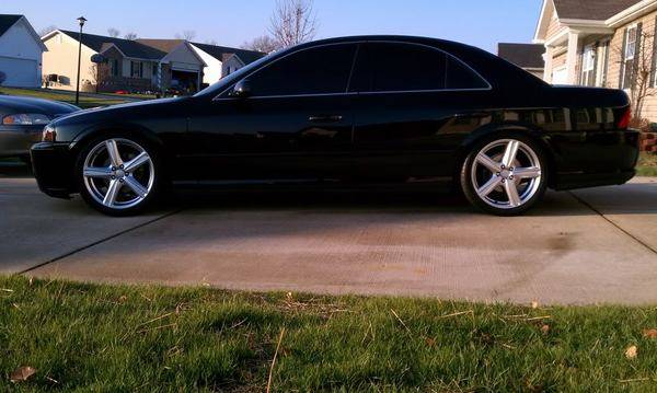

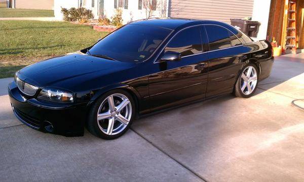

    Eibach Spring Pro-Kit
    245/35/19 tires
    V8
    Front driverside = 26 1/4"
    Front passengerside = 26 1/4""
    Rear driverside = 26"
    Rear passengerside = 26"
    About 150lbs worth of stereo equipement in the trunk.
    Ride and handling is good. The wife says "it does ride "bit" rough". I don't notice. Speed bumps are NOT my friend. I try to avoid them at ALL cost.

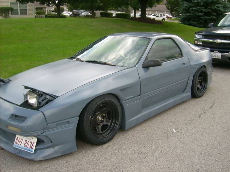

            We call it "JDM angling". It works. Had to do it a lot with the last beater/missle car:

            Is that an FC RX-7??

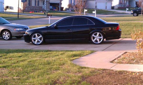

            Rollin,, I thought about getting some asphalt or concrete but the snow plows around her would prob snag on it,, I was thinking 2x8 board but I'm sure my neighbors would complain about trash,, I'm not touching yet,, just more concerned with the when or if I drop the car. If 245/35/19 will keep my bumper height close to where it is now I'll be happy.
            Alzimme,,, man not throwing stones,, but I dam sure don;t want my new bumper looking like that!!
            heres where I am at stock.....

            Its a 1987 FC RX7 I got for $240. Put about $1000 into it and beat the living crap out of it. First race, 1st day it was finished, I put it into a wall in 3rd; fixed nothing and drove it another 2 years.

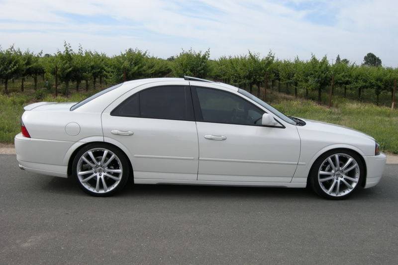

            2006 V8
            20"x8.5" Jaguar Senta Knock-off's from EuroTech - 49MM Offset
            General Exclaim UHP 245x35x20 Tires
            Eibach Springs
            Eibach Pro Alignment Kit
            F Driver 26.25"
            F Psss 26.25"
            R Driver 26.30"
            R Pass 26.35"
            Ride is great as long as the road surface is in good shape. Need to go slow on all speed bumps and some steep driveways are a no go. Need to be careful on parking lot curb stops or I can scratch the bottom lip of the front facia. Upon install of the springs and wheels had to adjust the fuel filter as slight rub on inside splash guard at full wheel lock. No problems since :D No bottoming out unless big dip/pot hole a freeway speeds.

            XFord, yours looks real nice,, I'm guessing I can stuff a 245/40/19.. if you got away with a 35 series on a 20 inch rim? I want to get a little taller off the ground.. I have that steep driveway you were talking about.
            Did you do the allinment kit because you needed to after the pro springs ,, or was it just time? Mine is an 2004 with only 60,000 miles and it all feels tight///
          • xford
            xford Well-Known LVC Member
            Messages:
            418
            Likes Received:
            18
            Joined:
            May 13, 2009
            Location:
            Newport Beach
            My guess is they will work as 245/40/19's will be just about the exact same diameter as my 245/35/20's. Go to TireRack and check "specs" so you can compare tire diameters.
            You do not need the alignment kit since stock is within tolerance for most applications. I just got it because it was cheap...
