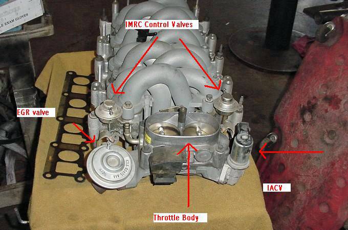

can anyone piont out the IAC in a pic for me, its a good thing i still have that parts mark, though it doesnt look much like a car anymore.
Looking directly at the engine, it will be the part that is mounted to the left side of the intake, right beside the throttle body. It has a plug that goes into it. It comes new with a gasket and is very annoying to change out but you will manage. The part nearly touches the firewall, top left next to the TB. You can't miss it.
Removing the hood makes it even easier to deal with but if you have no help with the hood, don't try it. It just helps to be able to get right on top of it and see. The passenger wiper and cowl will need to come off first thing before anything else. I think it's held on with 2 8mm bolts and one bolt is longer than the other. Break them loose first with a small 8mm wrench and then use a bendable long long extension with the socket on the end to finish removing the bolts. Reinstall the same way and tighten with wrench and then plug it in.
Here it is-just remove the engine...:D
