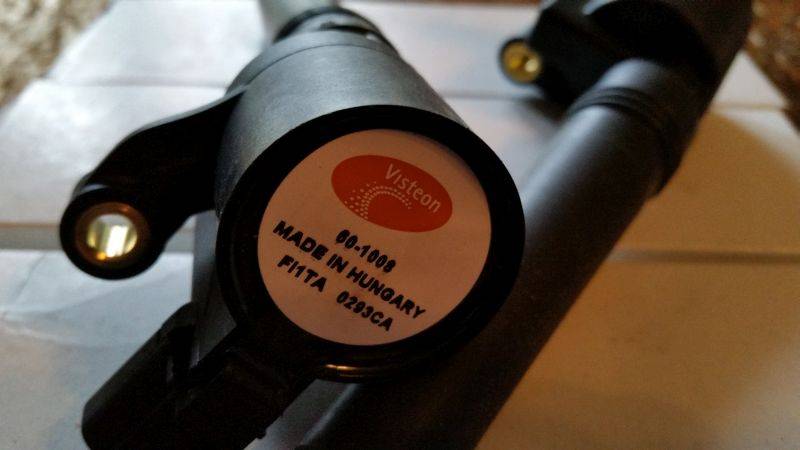

VISTEON coils are no longer, you'll have to put OEM Ford DG529's in there.

... Was it Visteon that made the replacements?
Visteon 60-1008 for the V8's ... can't get them anymore. :(

You'll see a lot of ads for them but if you call around, no one seems to have stock. They are discontinued.
If you do find some please do let me know, I'd gladly restock some more.
