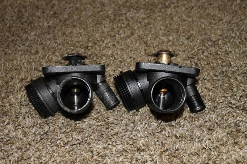

My 06 did recently did the same thing. After the engine warmed up the fan would turn on full speed and stay on full speed till I shut it off. The temp gauge always registered normal temperatures.
This was the problem. I replaced it and the degas bottle and it went back to normal.

Thanks, do you know what then part # is? Is it OEM?
I ordered from rockauto and it says Motorcraft part # RH134 and RT1163.
Max (ad to right) has the OEM parts. I don't know which (if either) is better.
BTW, you would be wise to replace the degas bottle at the same time.

Yes, the front part of the housing. The back part of the housing is what cracked on me (as well as the plastic part of the upper hose and the degas bottle.) I went ahead and replaced most of the other plastic cooling system parts at the same time. I think it was about $500 in parts.
Took the LS to the Ford/Linc dealer today as my car is still under its Certified Pre-Owned Warranty (expires in April 2012) . They got a P1285 code which I am told is a cylinder head overheat sensor. My car has never overheated to my knowledge so I am not sure why that code was thrown. If anyone can provide insight I would appreciate it. They did determine the T-Stat was stuck closed and replaced the entire assembly...good news total cost to me was $100 and they fan is back to normal.
