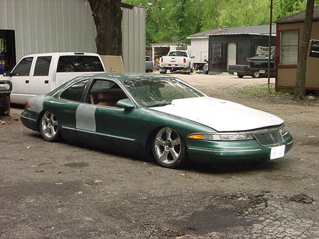

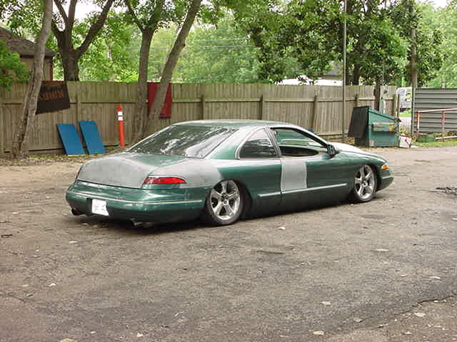

I talked to Eddie for a while about the struts. I wanted to decrease the overall length of the whole strut, thereby lowering the car without changing the dynamics of the strut. His solution is the removal of the bumpstops as already mentioned. Personally, I'm working on something else as a solutions for a Low Ride Lincoln Glide.
You know what, I forgot all about the cats, they weren't touching the ground, but they were DAMN close. I think I took pictures actually. They're around here somewhere. And that was with only one side dropped, the other side was still two inches higher.
Removing the rear bumpstops is easy and it'll sit on the rear mounts like you mentioned. The problem with having it actually touch the ground is that I drop mine all the way down as a reference point, then just hit the switches a couple of times to get the car in the right stance. When I had it so the rear would touch the ground, I couldn't do that because the exhaust would drag. Cool maybe if you're on the strip crusing, but not cool with a baby and a pre-teen in the car with you...
I want to be able to sit the car on the ground, THEN add some type of safety device so that under normal conditions, it doesn't actually touch when I drop her down. There's also a decent amount of bounce when it drops hard making it go lower than where it rests for a split second. I figure if I can get it down, keeping it up wouldn't be a problem.

That's just where it sits when aired out!!! That's the beauty of air, you can drive it at a decent height and get excellent ride quality, then drop it down when you park.
It's a little wierd for people who aren't used to lowriders because when you get out, it's kinda like getting up off the floor. This proves uncomfortable for some, including my girlfriend who drives a 4x4.
So to counter this, you keep the car up so your woman can get out, then drop the car with your alarm transmitter. You also need to raise it up just before you open her door to let her in. Just another reason to hook the suspension up to your alarm system. :) I know you guys always open the door for your woman, but if you're lowridin, you gotta raise it up too!!!

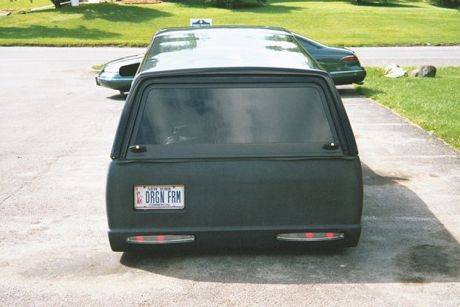

What Kale said......it will NEVER be low enuf for me.....but then again....I AM a MiniTrucker at heart......here is a few pix of my old truck (I no longer own it, but you get the idea):
