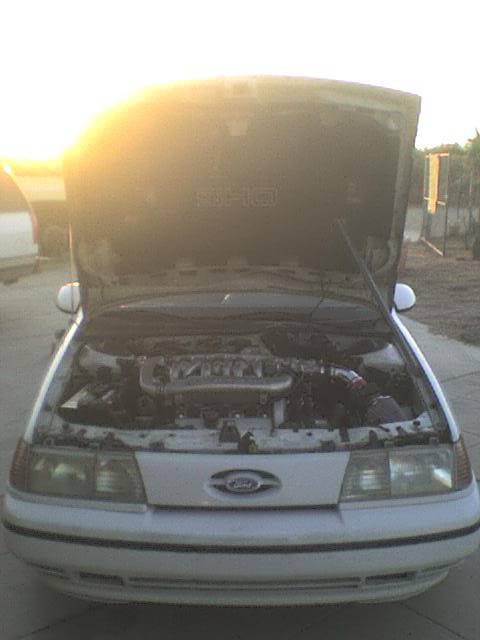

Where did you get that intake?

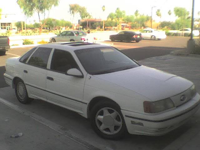

my friends and I all pitched in a bit to buy the car ($600) and mess around with it a bit. It came with that intake and a lot of bracing on the underside, it also spun both tires.
a 95 mtx huh? what color? the 93-95 manual trans cars are kinda rare. the 95s especially.
apparently its a sho shop "cold" air intake. they are no longer made. quit production about 15 years ago.
