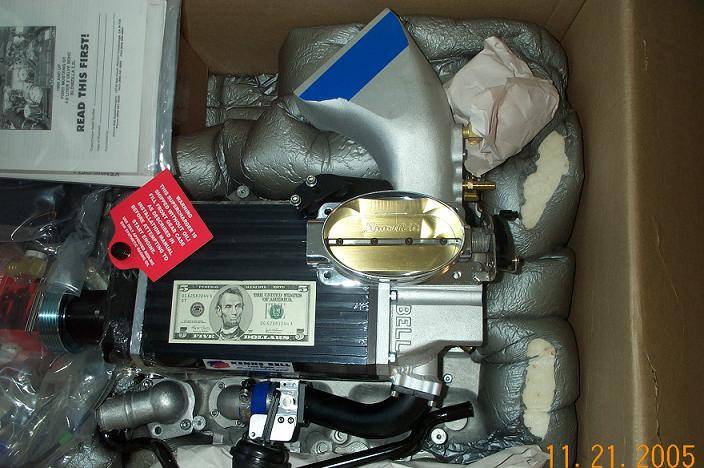

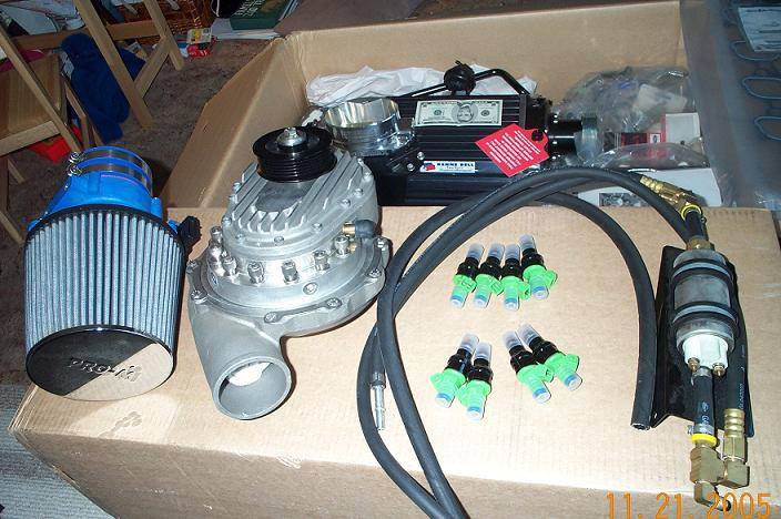

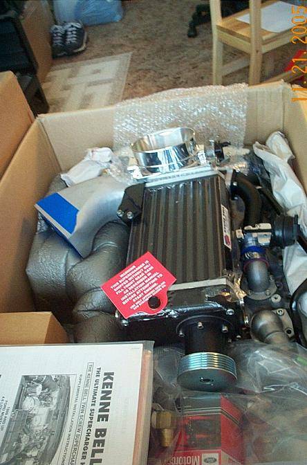

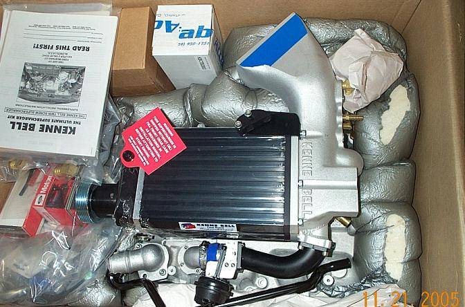

Look what arrived on my front doorstep today? KENNE BELL!!!
R
rocket5979
Guest
Yep, thats right. It is a Kenne Bell 2.2L for the 4.6 SOHC GT. This will NOT be going on the LS. It will be going onto my 2003 4.6 SOHC Explorer. The bottom end of the engine will be built with billet parts through VT engines and the 5R55W tranny will be built by Level 10. There are many other specifics to mention (Xcal2, BA2800 MAS, etc.), but I dont want to bore anyone. This is a fully custom installation so it wont be an overnight type of deal, but it should prove to be a fun one!
On a side note that is another supercharger you see there. It is a Powerdyne XB-1A (gear-driven) head unit with some other goodies that should be finding its way under the hood of the LS before this time next year. It is rated up to 18 lbs boost, but I will only be running it at 6 lbs due to the weak bottom end/high comp ratio of the DOHC 3.9's.
Once everything is said and done the Kenne Bell should be making right around 600rwhp on the Explorer (sleeper) and I will be happy with about 350rwhp on the LS with the XB-1A.
Enjoy!!!

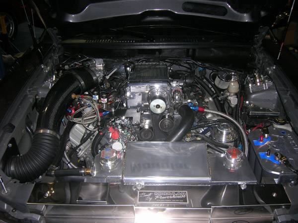

Looking good. I used to own a mustang so I'm on those boards a lot. I know MPH(modular powerhouse) is turning out some sick mustangs. There's actually a guy out of Houston who had his 2V there recently. Puts down 700+ rwhp on a race tune. i believe thats using a paxton, tho.
here's a shot of a different 2V 700+rwhp using KB
Yeah I think I know who that is. Thats the fella from Steen Racing if I am not mistaken, right? Badass centri setup to be making 700+ rwhp!!!
...and I will be happy with about 350rwhp on the LS with the XB-1A.
rough idea on the pricing for the ls job?
The bottom end of the LS really isn't weak. It is actually quite stout for 3.9L. The big problem is the transmission. IIRC, it's rated for ~350hp at the crank. Then there is the high compression......
I have the head unit from a previous project vehicle. The bracketry will all be custom fabbed by me and then I will send it off to be powdercoated.
Head unit $1800 (nowadays, not when I bought it)
Xcal2 $300 (depends on what GB's you may get in on)
Pro-M 80 mm MAF $300 (got it a while ago but I think it cost me that much)
32 lb injectors $250 (try to get used older Cobra injectors for cheaper)
KB Bap $??? (Only if it ends up being needed)
and possibly other stuff I am probably forgetting
