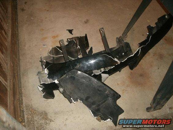

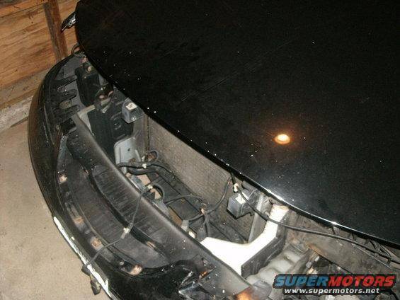

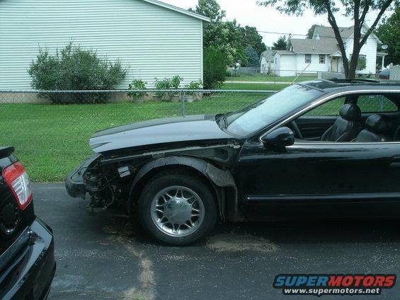

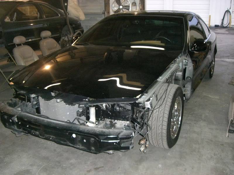

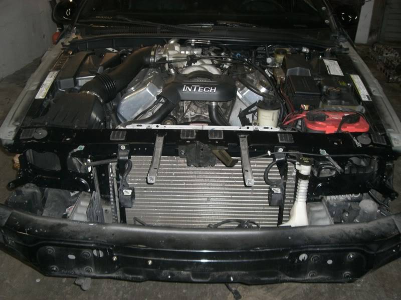

So I bought this car from another member and I'm working to get it ready to go in time for the Boscobel Beach Party in two weeks. (see Midwest Chapter for details!) I need both front fenders, header panel, headlight housings, bumper cover, hood latch and I believe that's all. I already have most of the broken stuff taken off of the car so I just have to find my parts now and she'll be back in shape. Here's some starter pics:

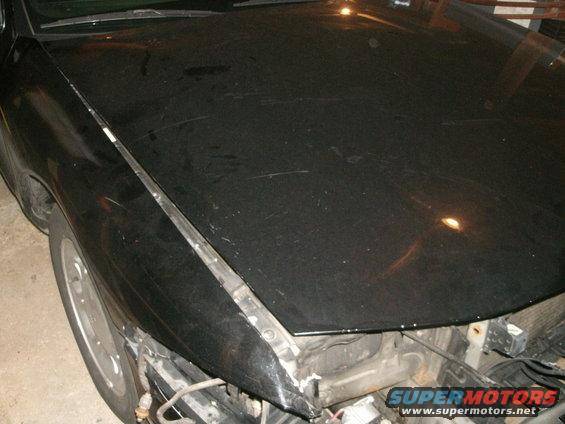

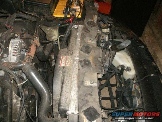

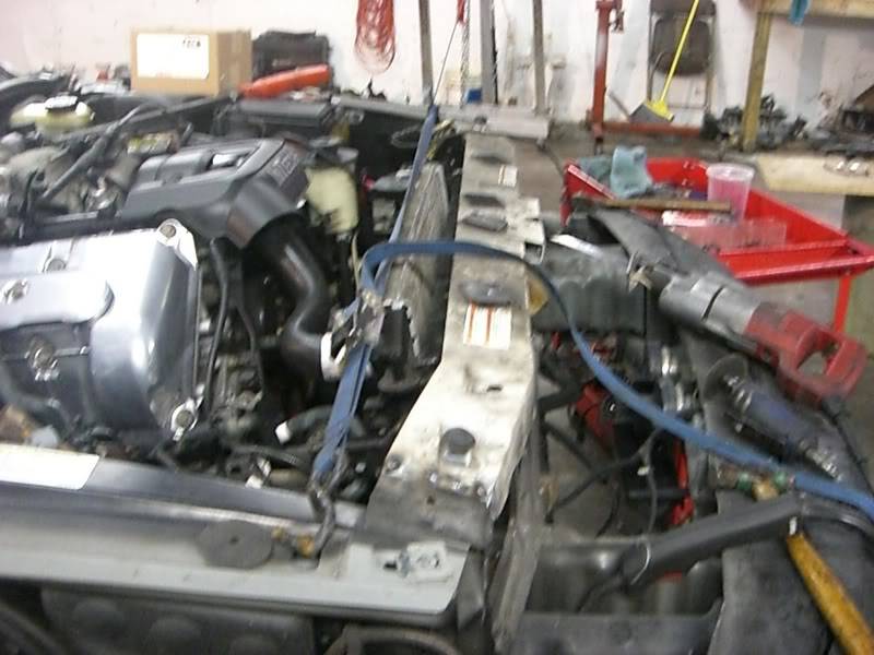

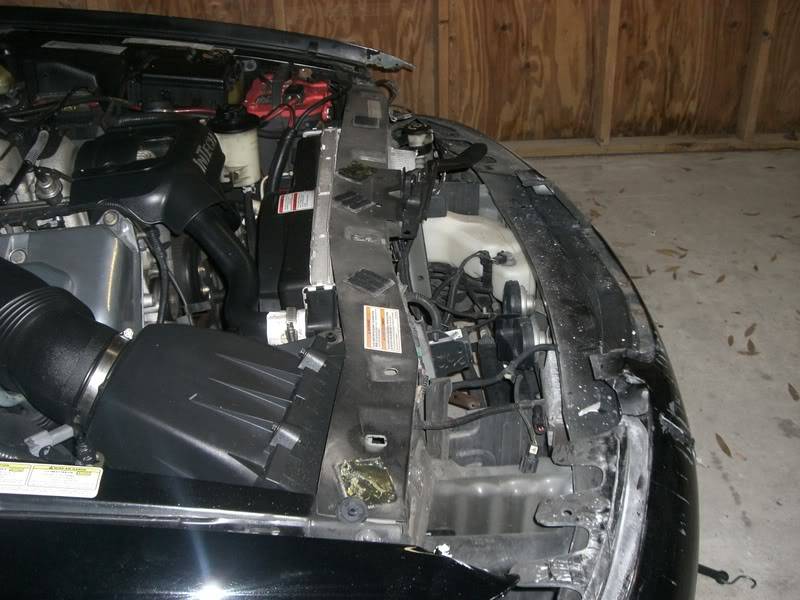

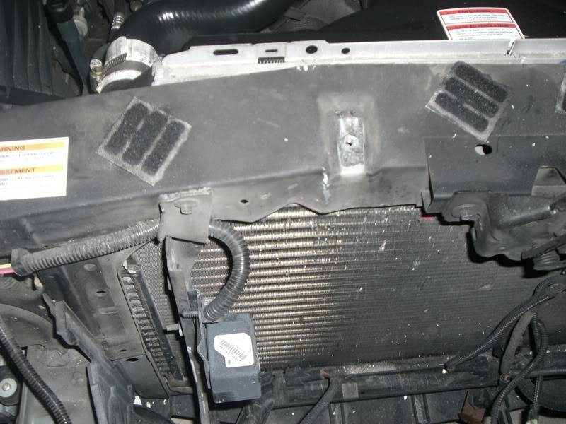

looks like you need to pull the radiator support as well
got the fenders and bumper cover pulled off this morning, didn't take very long to do. parts should be here either by the end of the week or sometime next week so hopefully we'll get it back together in time

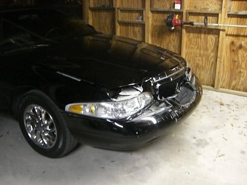

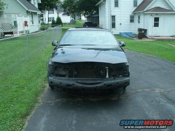

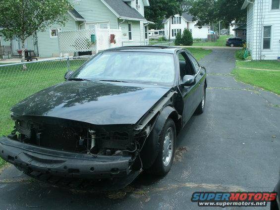

dude wow man i mean almost exactly to a T same crash as me. you can fix it easily, i did mine 100% myself even down to painting it. even your pictures look like mine lol!
wow seriously look at that !!
I would try pulling it....doesn't look terrible. If i can remember, i'll get some frame measurements for you from the book tom at work so you can cross tram it. If you still work at the dealership, it wouldn't take more than an hour to tie it down on a frame rack and throw a clamp on it.

jaime, i seriously looked at the first couple of those pictures and didn't even notice that it wasn't my car, haha that's crazy!
jeb, i don't work at a dealership but i might be able to get it somewhere to get it pulled, that or i'll hook it to a truck and give her hell...joking, haha
and rich, told ya i would get one when i got the house and stuff
You can probably do what I did to my old SHO. I rolled the car up to a tree, so that the bumper was resting on the tree. Then used a chain winch then attached between the core support and the tree to pull it out... worked like a charm and was really easy.
yes all you really need is something to anchor it too. You can use a winch or a cum along and the hillbilly harry way. anchor a chain or whatever and then slowly back the car up and put pressure until it pulls out to where you want it.

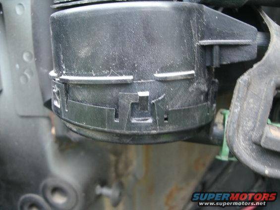

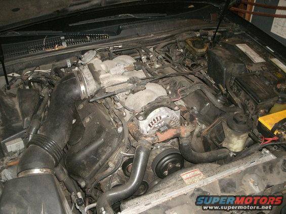

well this might be the dream killer as far as the car being ready for the beach party. found the cruise control thing has broken tabs and won't fully snap back together. can anyone tell me if this is something that needs to be addressed or if i can run it like that (which i doubt) but as of right now unless i can find a replacement looks like the milan will be coming to the beach party :(

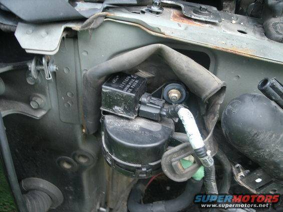

thats uhhhh the vmv i think (vapor management valve) it supplies the vac from the eng to the tank to check for evap leaks
english man!! you are right down the road, is this something that needs to be removed and replaced? or is this a duct tape item (j/k...kinda)
id say try just running a zip tie around it holding the cap on it might seal and if it leaks its no huge deal just might have a light for an evap leak

like this
well so far there is no cel, and it doesn't idle goofy or anything, but if it's not gonna catch my garage on fire or strand me on the way to wisconsin....haha
