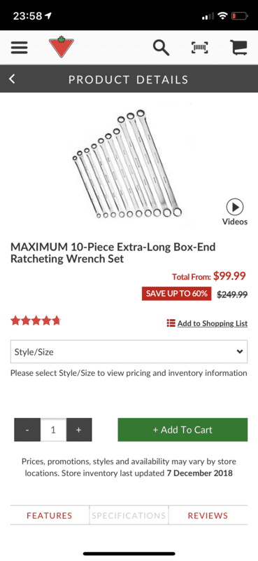

Dead thread revival, I used slim, extra long double ended ratcheting wrench, about 14” long with a 5degree ratchet action. If I had bought these in the first place it would have saved me 4 hours of swearing on the first side.
