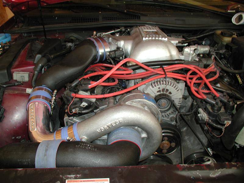

The second is the Vortech mentioned earlier, which looks like the one below, is also belt driven but is mounted on the front / side of the engine:
