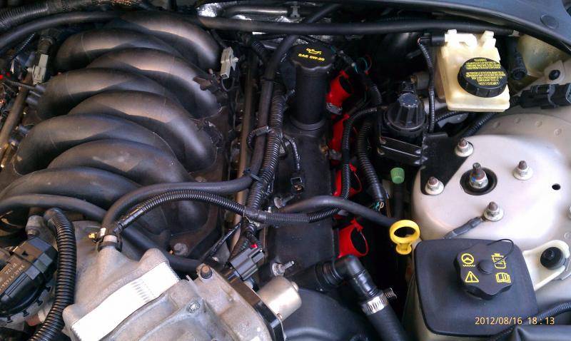

I have them, no perfromance gain, maybe better throttle response, hotter burn. Only problem is though, I had to pin out the original connectors and swap the B+ to the other side becuase the coil pins are different then LS stock pins...well at least on MSD coils anyway, ACCEL's might not be diffferent.

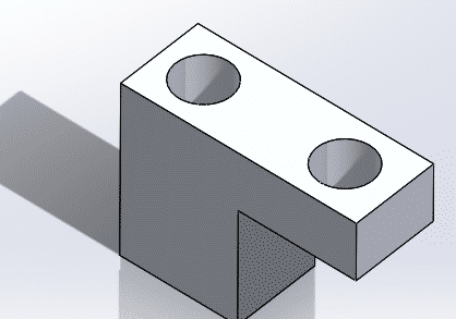

I'm doing the Accel COP installs and I was just wondering if anyone here could tell me where to start on making brackets for the Coil?
The bracket looks like this. This is a quick drawing. I don't have the actual dimensions used. It looked like they were cut from an aluminum bar of APPROXIMATELY a 3/8 x 3/4 cross section
The long leg goes on to the valve cover. The coil tab goes under the short arm. I found it easier to bolt it to the coil, then screw down the bracket to the cover
