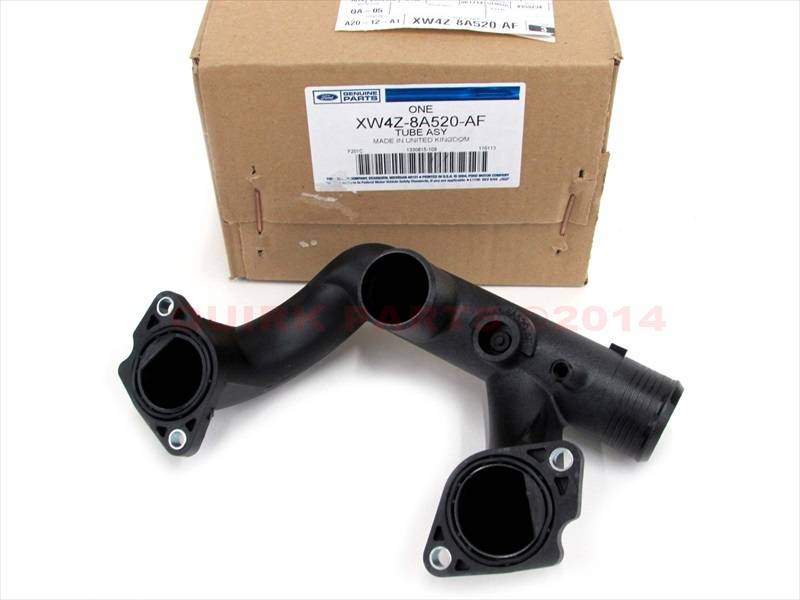

This thing? http://www.lincolnvscadillac.com/fo...13-Re-amp-RE-OEM-Coolant-Outlet-Pipe-GEN-1-V8
Your LS V8 is an 00 to 02?
If so, It's the Upper outlet tube from the cooling system.
8A520 Coolant outlet tube
Genuine Ford Part # XW4Z-8A520-AF
Currently on sale, US $41.26 - UPPER PIPE - FORD (XW4Z-8A520-AF)
from Tasca // http://www.tascaparts.com/oe-ford/xw4z8a520af
~ GLWR
PS: you are going to need a whole bunch of other plastic cooling system parts at this point, wait till you go to refill the system in order to rebleed, the fill neck will crack as you attempt to loosen the cap. You'll need a degas bottle soon also (if not already done) Thermostat housing replacement, go with the Aluminum JAGUAR upgrade.
By that brown looking color of where it snapped, the entire plastic cooling system looks like that on the inside, it's brittle, brown and ready to crack, won't hold pressure, let's air into system, unable to bleed correctly = overheating.
~ just saying

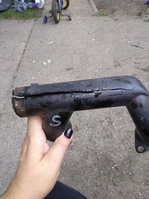

I just had my coolant flange blow too, I have replaced the degas bottle, the thermostat housing, the thermostat, all the crap factory clamps, all the rubber hoses are sealed and not leaking, have I missed any other plastic parts other than the flange that just blew up on me :( I am so sad and just want my car to be great again. This is what my flange looked like after blowing coolant all over my entire engine block :( I just want to make sure I get everything this time, because after 2 months of down time I am so ready for everything to be fixed and all better. I have a 02 LS V8

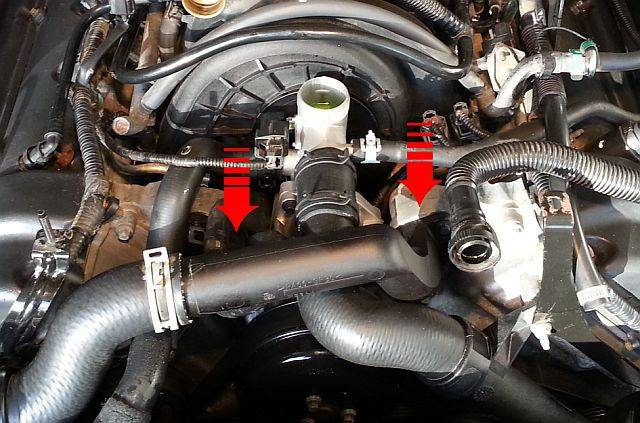

The upper and lower radiator hoses have plastic sections. These will be the next to go if you don't replace them now.

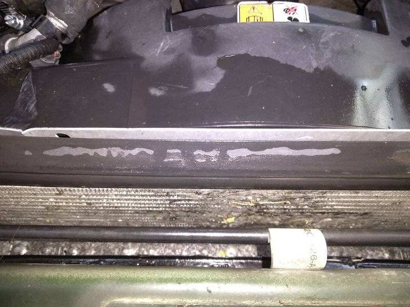

Also, you should take the appearance cover off over the radiator and look at the front side of the passenger side radiator tank. Look for any residue or crack near the top. If you find it, then it's new radiator time too. After that, you should only have the DCCV and aux pump to worry about. I'd wait till those start leaking to change either.

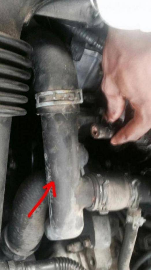

BTW, it's best to say which generation (or year) your LS is, as well as which engine. Fortunately, it's clear that it is a 1st gen V8 from the part you have in the picture.

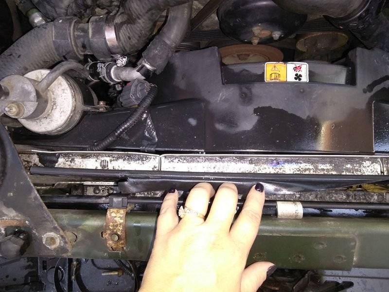

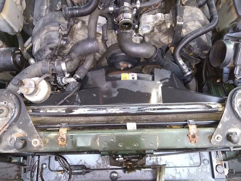

EVERYTHING is soaked under my hood I forgot to say once it blew my abs light lit up, and my traction control light lit up also. I took the plastic cover off and looked at the radiator, it's soaked too, but the rubber part on top almost looks burned on the sides. It doesn't appear to have any cracks, but it's def dirty as ever. It has a ton of stuff on it. Sorry for the bad pictures, but it's a mess under here right now. I also should add that the plastic cover wasn't bolted down, it just came right off.
Sorry, I guess I wasn't clear. It's not the top of the radiator you need to look at. That's just a metal rail. It's the front of the plastic side tank on the passenger side. You may need to remove the upper radiator mount on that side to see it well enough. Here's a picture of the front of the radiator with the surface of concern circled in red.
Oh, ok. Thank you! I told ya I wasn't sure what I was looking for. I will go out and check that in just a few minutes. Thank you again!!
