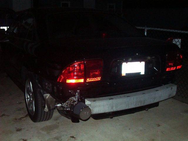

Hello, My name is Mike, I am new to this forum, just came across it and just wanted some input on a certain topic. I own a 2001 LS V8 and have always been interested in forced induction on it. I have seen the Special Vehicles LS, and have read nothing but bad news on it. I want to show you my turbo LS and want to know if any of you, or anyone you know has attempted to do something similar. These are pictures of the completed install. I was very happy with the results, and could not believe the power. It was driven like this, under constant tuning for about 3 weeks. Then, unfortunately I fryed the bearing/seals in the CHRA and decided to get a better quality turbo, and find a way to put it in the engine compartment.
Details:

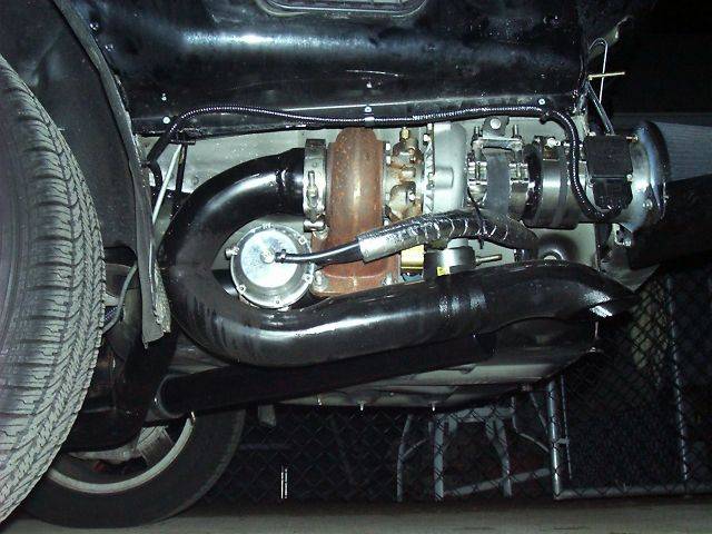

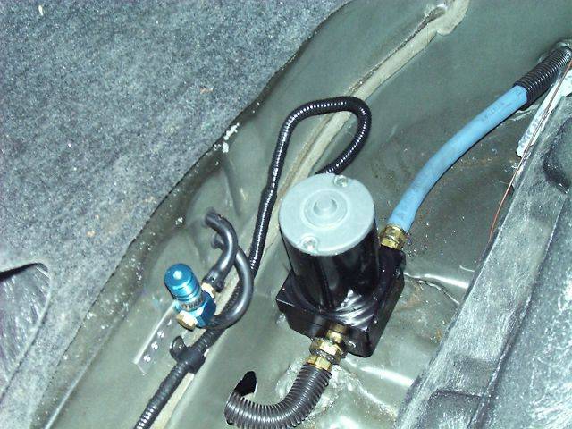

First of all, i'm sure you are wondering why the turbo is located in the rear of the car. This is because of the lack of room in the engine compatment. It was mostly an experimental thing. The largest concern when doing this is obviously pumping the oil back to the engine without creating any backpressure on the CHRA. And yes, the whole assembly DID fit behind the stock bumper cover, with the only major modification being about 3 inches of the aluminum inner bumper being removed on the pass. side.
Garrett T04E Turbo
TiAl Waste-gate and Blow off valve.
Custom plumbing
Zone 5 MAFterburner MAF tuner
5.0 MAF trimmed and polished (off of 2000 explorer)
K&N cone air filter
Autometer cobalt series Air/Fuel, Boost/Vac, Fuel Pressure, Oil Pressure
Meizier electric water pump used for oil pump
Turbo XS man. boost controller
Alot of time and frustration

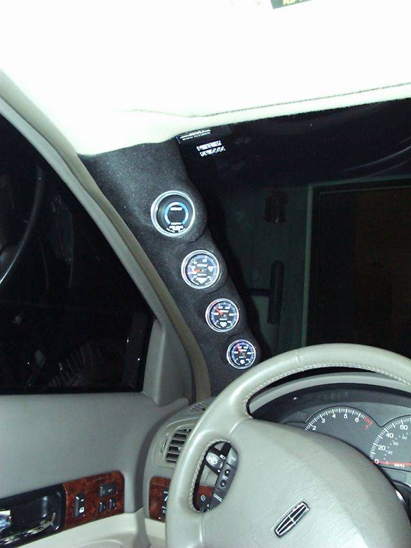

Here is the A pillar with the cobalt gauges. Made with expanding foam, and fiberglass. It has been recovered with cloth to match my interior since this photo was taken.

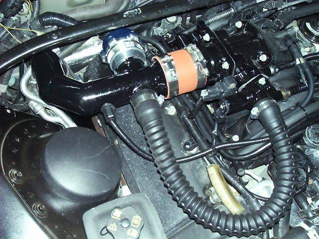

Now, as for the charge pipe. Think of it this way. Take the distance from the rear bumper, dirctly to the throttle body.
Now, think of the distance it takes on a stock turbo'd vehicle to go from the turbo, to the front bumpers intercooler, then back to the throttle body.
At most, i have an extra 2 feet.
Now the second advantage i have is that the entire pipe acts as an intercool under the vehicle as it passes through ambient air.
Air that would be passing through an intercooler would have much more restrictions, and pressure losses.
Air inlet temp at the TB never exceeded 100F
Pressures at the manifold matched pressures at the turbo according to seperate guages. (boost gauge conected to TB via disabled PCV port. Second pressure gauge T'd in at the turbo outlet before the wastegate input)
