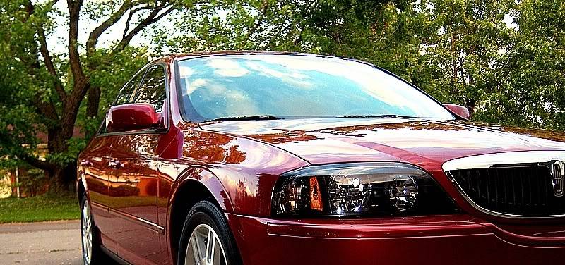

I wish I had the extra cash laying around to buy half the equipment I need to properly detail my car. Although, the girlfriend would probably leave me, since I'd always be out in the garage...

You can make your car look just as good with regular washings and Ice wax, there is no need to buy all that garbage.

You can make a car look nice with some pretty easy effort but this car looks better than factory!

there is no possible way a regular wash and wax will get rid of swirls and spider scratches the way that "all that garbage" does.
I'd love to have him treat my car. The dealer I bought it from messed it all up with their buffer. Whenever I wash it, you can see all the buffer swirls in the sunlight. It needs that treatment!

Hey man....the Ice wax is pretty good. Several on here use it. If I want to really get it shining I use Zaino.
It puts a good shine on the car, but so does Olive oil. Do some serious research if you want a real shine that protects as well. You need to prep the paint before you apply all the glossy stuff (Glaze, Wax, Sealant). Zaino is a good product.

-1. clay bar does a good job decontaminating the surface, but does nothing for getting rid of paint swirls.
Dont' get me wrong, clay bar is a great step, and should be used, but it's intended usage is not for paint correction.

Yes, I'm pretty into detailing. The Flex is an excellent machine. If I recall correctly it can switch between rotary and orbital and has 60% more power than the Porter Cable 7424. I have the 7424 and also like it alot, a very useful and cost efficient tool and virtually impossible to screw up on the paint.

I agree and disagree slightly. The clay bar won't do anything to remove swirls, but as far as paint correction goes it is a crucial step. It is commonly overlooked by amateur/weekend detailers and is necessary in paint restoration. Removing the embedded dirt/tar/bugs/rain deposits is just as important as removing swirls and scratches. It can be a dangerously skipped step using a power tool and can cause even more scratches and marring if the paint you are correcting isn't completely clean. I apologize if I interpreted what you said wrong. The only step in a paint correction that *can* be skipped is the application of a glaze.
