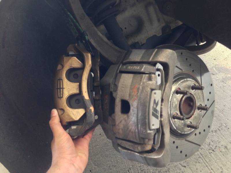

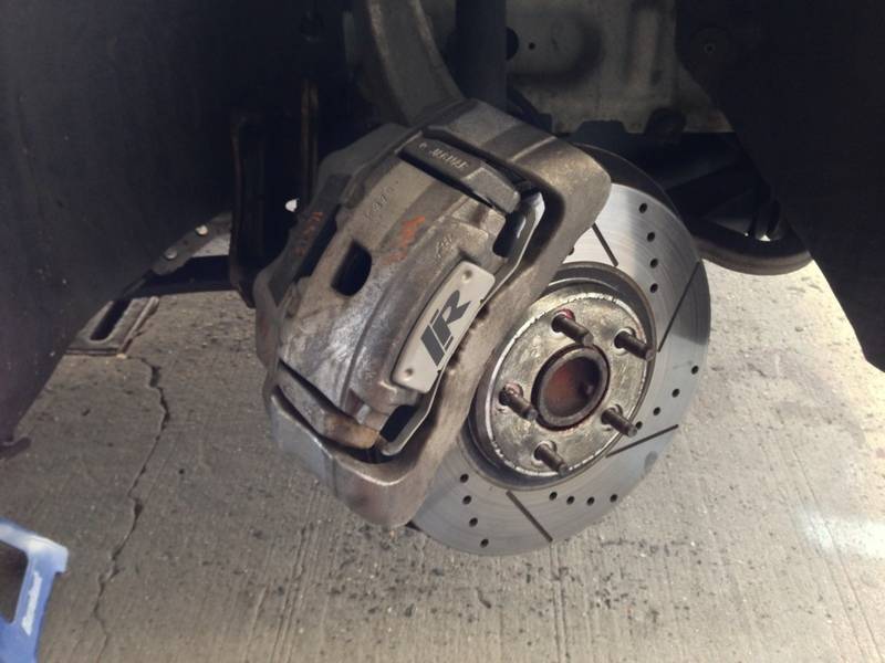

Jag Big Brakes:
-Pictured are my stock (size) rotors.
Stock vs Jag Big brakes: (This is the Lincoln Star I want to put in place of the "R")

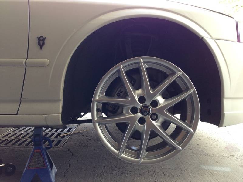

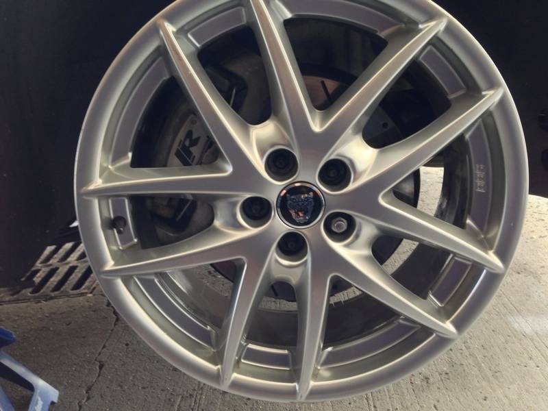

I have not completed the upgrade yet. Waiting on tires for my 19s or another set of reasonably priced 18+ wheels. The calipers won't clear the stock 17s.
