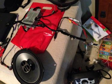

Didn't do the rear sub amp install since I don't have the materials yet (need a long audio cable and 18 gauge wire from front to rear) I did try checking the sub woofer amp and speaker for my rigged wire harness. I used the existing plug to get +12v and just provided a connection for the remote amp. I don't know why they called this sub woofer amp, it doesn't really produce bass. From my research the sound generated here is too subtle as not to empower the front. It sound like sorround speakers. So if you want more bass thumping sound this amp is completely worthless and upgrading the speakers is also a waste of money.
Below is my rigged setup for testing the amp and speakers. I also found out that all stock speakers are bad. With low frequencies, I could hear nothing but distortion.
