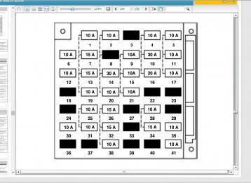

Does the little sidemarker illuminate on the left taillight? Is the amp still not functioning? Is the front left turn signal working?

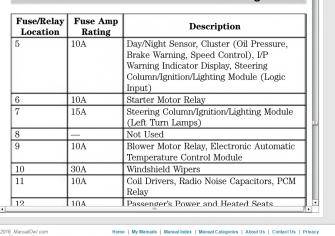

If the front left is out as well I'd put a different fuse in slot 7 which is a 15a, I've had good looking fuses not work.
If the fl signal is working then I haven't the slightest idea.
