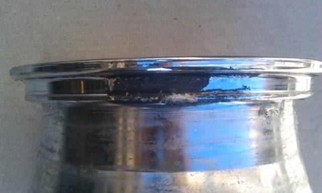

*Edit. I included a pic of the corroded trouble spot. The tire loses about 5-6psi per day.

I used to work in a plant that actually made OEM aluminum rims. We did not do any chrome work at all but I will say that we did corrosion testing on the rims with salt spray. I know that when you go into a tire shop and show them a chrome aluminum rim they say that it is the chrome that causes the problem but that is not entirely true.
Once the wheel starts to corrode enough to remove the chrome there is a major issue. The aluminum alloy base of the wheel has become pourus. This is not something that can really be fixed without a sealer or some sort, but please remember that it will start leaking somewhere else on the rim. If you could presure test the rims, as we used to do in the factor, from the outside in you would most likely see the rim leaking in places you could never imagine. I have seen it.
Once the rim has started leaking there is really no way to go back. Corrosion is the cause and once it starts it will never stop.
Normally the problem he is having is caused from wheel weights
Op don't forget that primer is not air tight you will need something to seal it
