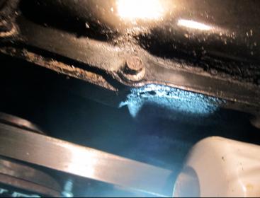

Hi everyone,
I have a 2000 LS V8 with 110,000 miles. The car has been in the family since it was new and now, since I'm a senior in high school my Dad has passed the car down to me. For a while now the car has been known to leak coolant periodically, even though it has been well maintained over the years. Every once in a while we would just refill it.
Just recently we were doing an oil change on the car and noticed that the oil pan was covered in black grime/flakey crud. Looking through the space behind the oil filter we also saw more grime on the bottom half of the engine on the driver's side. We cannot identify the problem, but we think it might be a leaky water pump, an old oil pan gasket, or leaky lower gaskets. Could it also be that the coolant is somehow leaking down there? We replaced the valve cover gaskets 3 years ago and have never looked underneath the car since new so maybe this grime is from 3+ years ago when the gaskets were leaking?
Has anyone ever experienced these problems on their early model LS and tell me the costs to repair.
Also, is the coolant leak fix a DIY repair job and what is the price if I hand the problem over to a mechanic. I heard these cars have leaky degas bottles, but could there be something else causing the problem??

Coolant leaks are well known and well understood on the LS. It is not too difficult to fix, and it is not going to be the water pump. Please search theses forums just a little. All of the plastic cooling system parts need to be replaced.
If you also have an oil leak, you'll have to clean it all off to find where it is. Suspects would be, valve cover gaskets (yes, it can leak down the front of the engine), front timing/engine cover (big pain), oil filter adapter seals (not too bad), between the block and the sump body (forget about it), ...

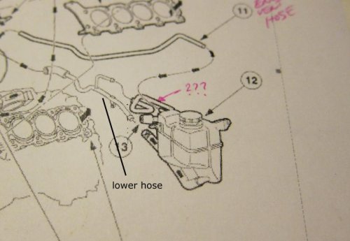

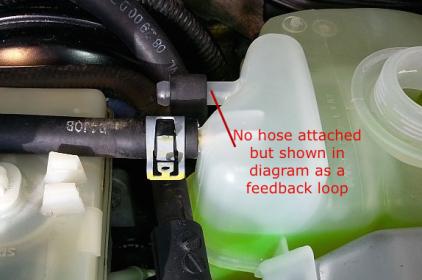

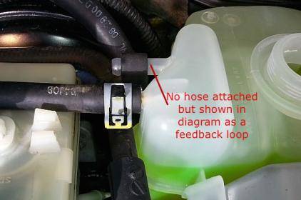

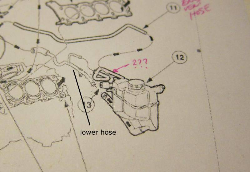

Hi guys,
Thanks again. The car already has the Jag thermostat housing and aux. coolant flow pipe. I will check the coolant outlet pipe for cracks and order a new one if need be. For the degas bottle, I can't find one with the attached lower hose that looks like the one in the diagram (main hose with the a smaller vertical hose branching out of it), can anyone refer me to a replacement parts website that has the correct degas bottle and lower hose. And I know this is probably a stupid question but where does the lower hose connect to (it’s a little unclear on the diagram) and is it accessible without having a lift?
Also, in the diagram, there appears to be a hose on the open valve near the coolant bleeding valve but in real life, there's not one on the car. Is that something the manufacturer put on the cooling system diagram but not on the actual car?

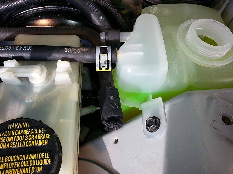

The lower hose attaches to a metal pipe that joins with the return line for the heater cores. This is on the firewall and is accessed from under the hood. You are looking for the Ford degas bottle with a simple hose attached to the bottom of the bottle. It also comes with a new heater bleed hose that clips to the top of the bottle, but does not "attach" to the bottle. Only two hoses attach, the bottom one, and the engine air bleed at the top. All Lincoln LSes use the same degas bottle.
The part you see on the diagram, "main hose with the a smaller vertical hose branching out of it", is the metal pipe assembly that is on your car that the degas lower hose attaches to. It doesn't come with the degas bottle, it's not a hose, and it doesn't need to be replaced.
The diagram is correct and your car is correct. You are misinterpreting the diagram.
... Also, in the diagram, there appears to be a hose on the open valve near the coolant bleeding valve but in real life, there's not one on the car. Is that something the manufacturer put on the cooling system diagram but not on the actual car?
Clearly, from that pic of mine you used,
.... anyone can see it does NOT have a hose coming from it, it's closed on the inside, it only serves purpose as a "hanger" for that bleed valve line.
In your diagram, where #13 points to, is in fact the Air bleed Valve. It routes below that nipple, it only hangs from the nipple.
This image here from the repair manual, clearly illustrates it.
