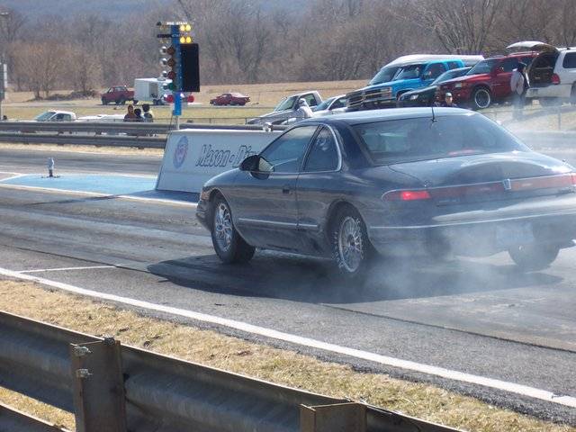

why is your car so dirty in the vids at the track
The track is 2-1/2 hours away, across the mountains and through all the nasty road salt along the way. :(
