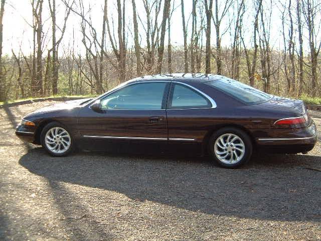

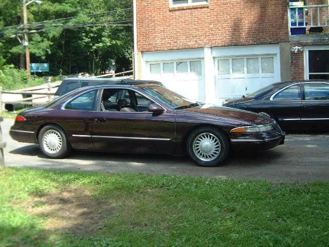

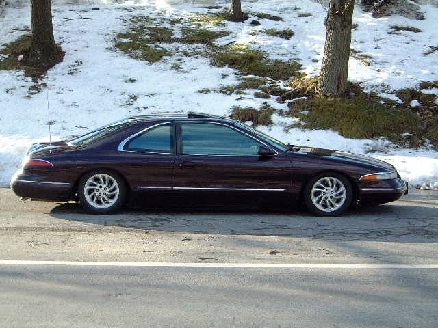

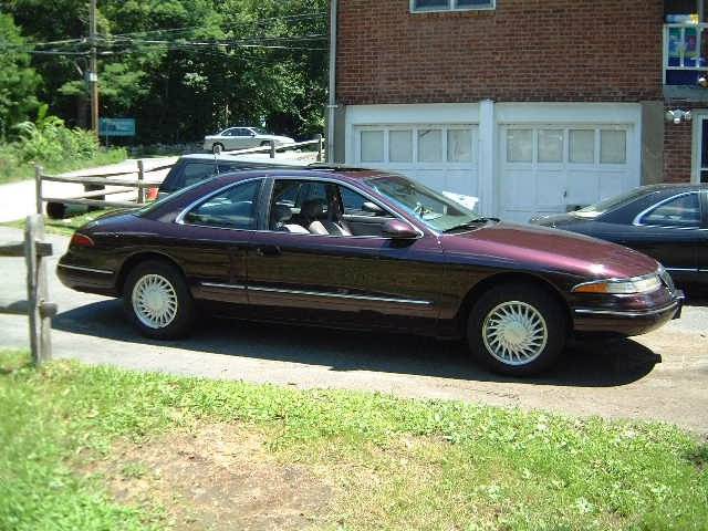

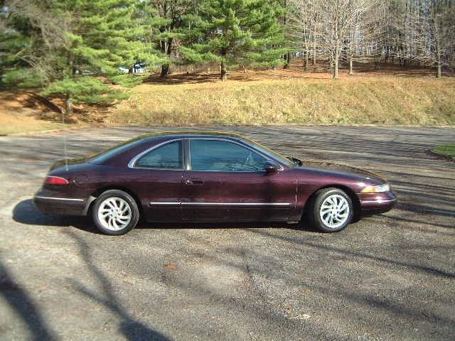

Basically what it is is you add switches (or a single switch like I have done) and you can manually lower your Mark. You can also sensor lower it as well. Here are a few examples:
Before Sensor lowering:
After sensor lowering:
Kale mod (Ray style):
I hope that answers your questions.
