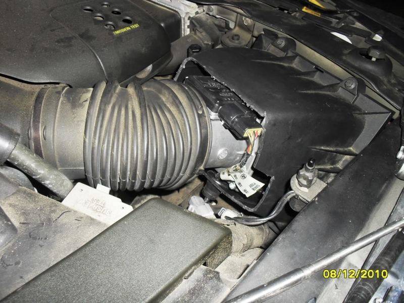

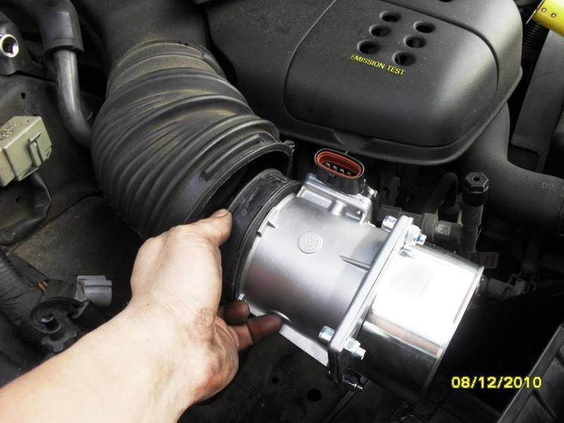

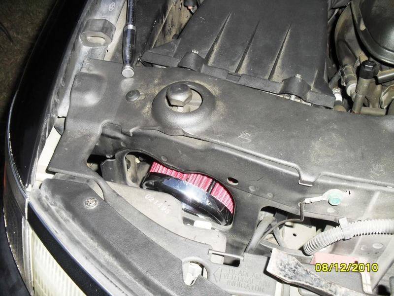

i did the Leo stealth mod to my air box and used an 8 inch Spectre filter from Autozone and a MAF adapter from Fleabay. Didn't notice much more power but sounds better. Cut a little too much of the back of the factory air box lid but I know where there are two in the junk yard so no worries.
Fleabay MAF adapter, I believe it was 3.5 inch diameter.
I know, I know, I cut a little too much off the airbox and it needs to be smoothed down but for the most part it looks factory from the front of the engine.

I wouldn't bother with an other air box, just get some tin snips, rivets and some aluminum and fab up you own. I do like the adapter though, I might have to get one.

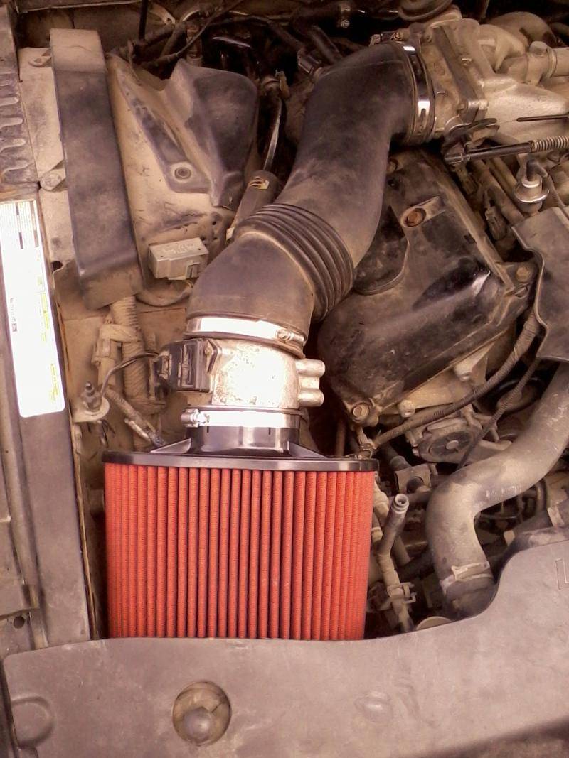

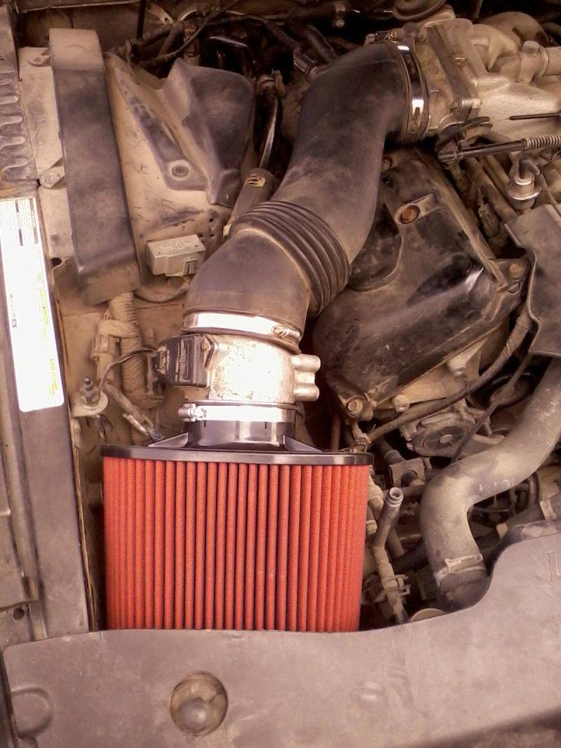

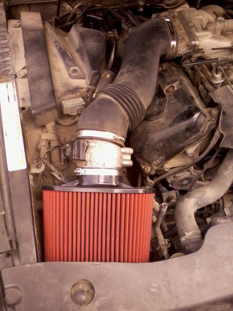

If you're gonna get an aftermarket filter, I'd go with OEM, they make a washable/reusable filter with no oil. Ive used spectre and k&n on a cherokee but i like this one the best
97 lsc
That's like the one that came on my LT1 Corvette Engine that came in my Master Craft boat and if is meant to be oiled. My 65 Vette came with an oiled air filter long before K&N existed. You are supposed to sparingly oil where the air enters the filter,not on the other side. I have never figured out how people get oil on the MAF,unless the over saturate the filter or the wrong side. My 2cents.
Where do you drive that your engine bay gets that dirty? I lived on dirt roads in PA and my engine bay never ever got that dirty.

I would suggest not to go the pictured route due to the assault of water, dirt & heat on the filter. Air boxes are an important part of consistent performance and the longevity of your engine. If you want to keep the all the expensive engineering the factory went threw AND improve "clean" air flow to your engine mods, I suggest taking a look at modified box designs that do that. If you are a do it your self-er, take a look at what I did for flow and great sound as long as your exhaust dosent drown it out.
