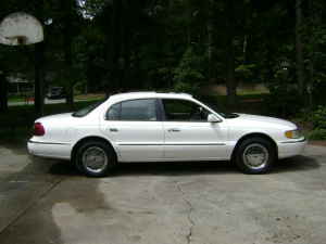

Hi, I just Purchased a 1998 Lincoln Continental with 138k in Good shape except for a few minor problems. I have been a member here for a little while and also own 2002 LS. Here a few questions I have about the Continental. The model I have has the Floor shift console. The prev owner also did not have the owners manual.
