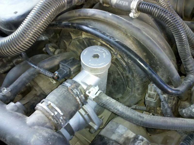

Got mine installed today. The parts fit perfectly. I'll see if they bled the coolant properly tomorrow, but the heat is working so that's a good first sign.
$51 for parts from Rockauto, $125 for labor at the local shop.

$125 at a local shop isn't too bad (for as little as I know about fixing cars & shop rates). I was going to attempt the install myself, but if I can get someone to install it for that amount, I'm sure it will save me at least SOME frustration. :)

Mine's at the shop getting installed as we speak. Will post back when it's done.

For anyone looking for details on how to replace this part, here is a link. It's for the jag s type but it's the same part and project. Good luck, replacing mine this weekend.
