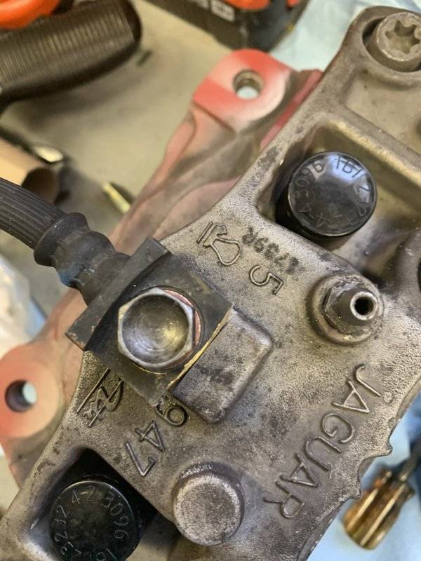

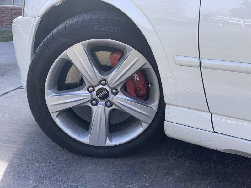

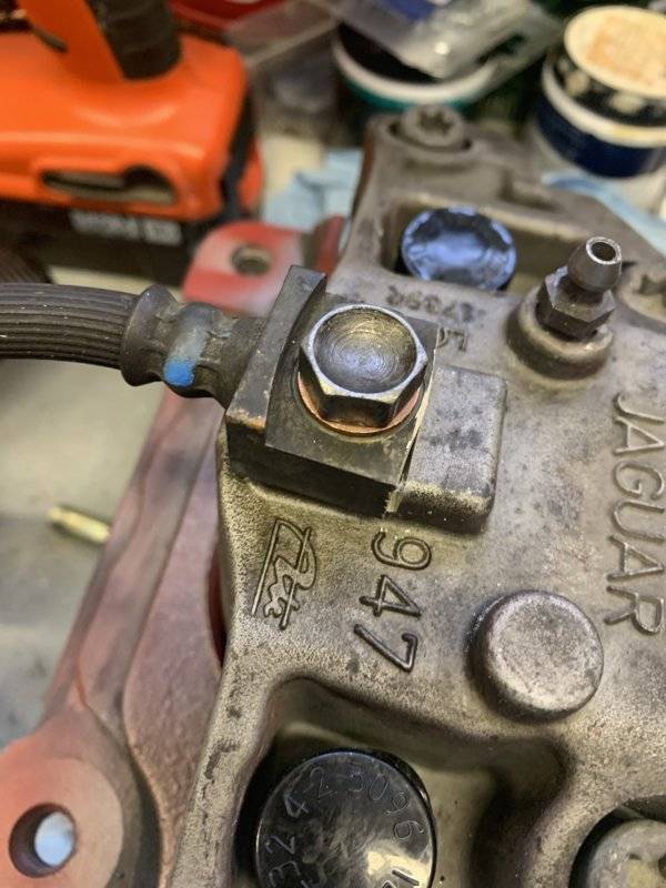

Finally got my front Jag big brakes installed. One hitch was that I am using the existing stock hydraulic lines. I had to file the caliper and grind one side of the line to get them to fit. Other than that, they for great. I really scratched up the paint on my pssenger side getting the clip installed.
After bleeding and doing the break in procedure, I really noticed a marked improvement in stopping power....they look pretty good too!!!

Power Stop stainless braided lines for the Jag might be a better option... and further improvement. The front lines for an LS will work... but are a little shorter. However... with careful routing... it is a non issue.
I see you went with actual Jag calipers. The stock LS calipers work too... with just a bracket change to the Jag version.

Thanks! Yeah, I had to reroute the Brake line around the shock. Also need to do some paint touch ups...and get a set of rears.

Probably a stupid question but would these brakes be to big for the stock 16" wheels?
FDR
Jan 20, 2014
2,029
161
Central NJ
Jag StR 18s barely fit and some aftermarket 18s won't clear either due to ribs/fins/steps inside the barrel
The 320mm rears fit in stock 17s though
