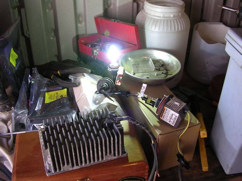

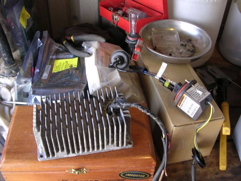

Was at home and had a ballast, an old bad hid bulb, and a cheap hid bulb and thought, what if?
Well here's the result. It ain't purdy, but it works!
Well that proved my theory that an hid bulb will work like this, it really doesn't care what kind of voltage it gets, it is the supporting electronics that get pissy.

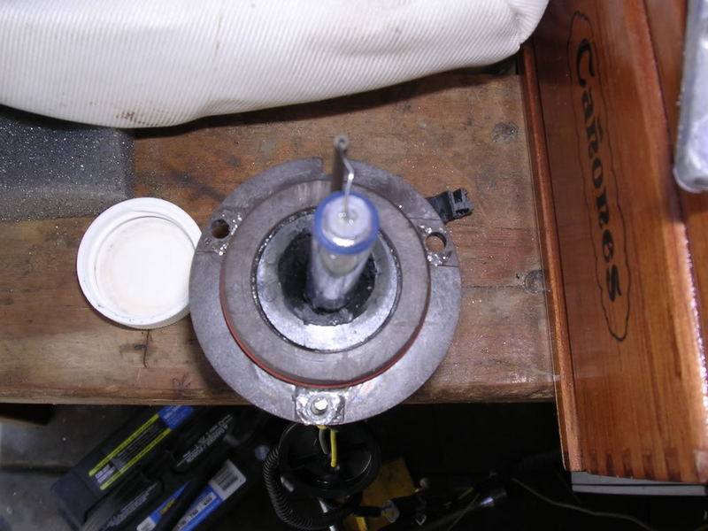

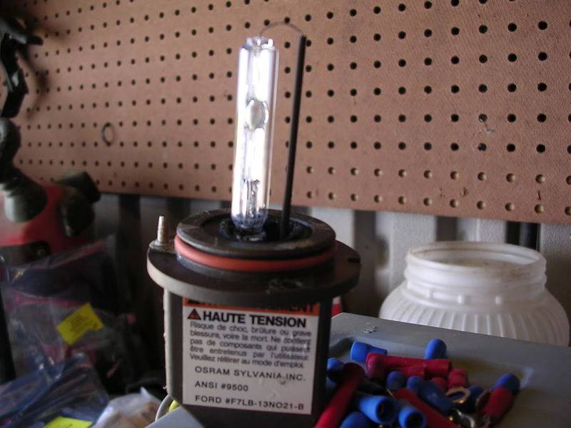

I remove the old bulb completely, leaving 2 wires sticking out. The shorter one was the + and the other was -. I removed the base from the cheap bulb and using liquid solder and j.b. weld, I got the new bulb on the ignitor. I aligned it before the liquid solder and j.b. weld cured.
Here's some more pics
What ya think?

That I don't know about, but I figured it should be about the same as the aftermarket kits. I do know that it is AC voltage to the ignitor (brown box behind the bulb) and that is where the incompatibility lies whereas the aftermarket systems have the ignitor built in the ballast.

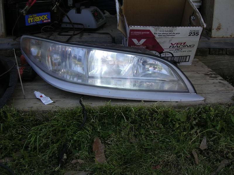

They are just as bright as an aftermarket kit. However there is one flaw that can make this a feasible alternative to anything else. Alignment of the bulb to the ignitor is critical as I had set mine about 1/16 to 1/8" too low. There was not enough adjustment in the headlamp to bring it down to where the beam needed to be. If you can get this adjustment dead on (more than 1/16" in any direction is probably going to be the limit) before the jb weld sets, then you are good to go. Now I gotta work on a jig to align the bulb.
