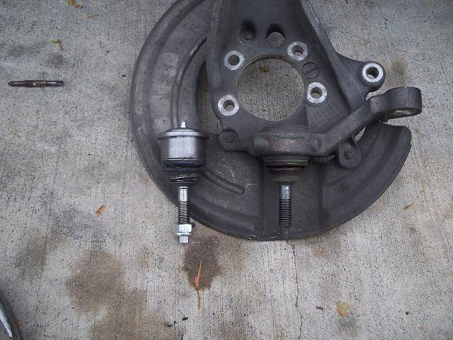

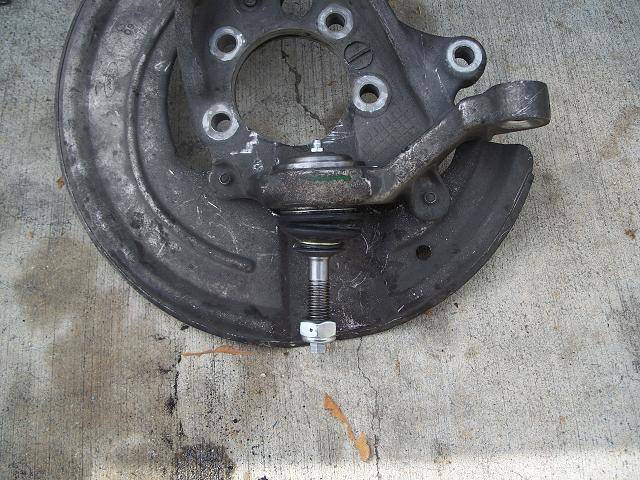

:D Saved :D over $375. Each knucle was 260. Labor would be free since I do the work my self. I purchased a set of ball joints from euromarque on ebay for $120 (mention lvc and get free shipping!).Then I removed each knuckle assemby and took them to a local mechanic, and charged me a whooping $40 bucks to press in the pair :D . Came back home, installed them, and the LS felt as soft as a cloud.
Knuckles: $120
Labor: $40
TOTAL: $160;)
Dealer parts: $610
Dealer Labor:$450???
TOTAL: $1000+:eek:

I didn't really use a press. I used a ball join remover its like a c-clamp. I first cut the threads off with a cold saw. Then I stuck it in the oven for like 10 minutes at 450 then. Pulled it out and presed it out. Put it back in the oven for 5 minutes then I had the new ball joint sitting in the frezzer. Dropped the new one in. Took less then 5 hrs to do it all.

Well, the oven/Freezer method got my new ball joint 1/2 way in! :mad:
So, it's at the machine shop today to get pressed in.
Just for the record, I cooked it at 300 degrees for 20 minutes. Froze the ball joint for 20 minutes as well. Apparently that wasn't long enough!
Got it pressed in for $20. Still MUCH cheaper than factory parts! Other than that, the removal and re-install is no big deal.

I haven't seen a how-to, but it is really a pretty easy job. (Aside from needing a press to press the old out and new in.)
  1. Take wheel off.
  2. Take brake caliper off and suspend from spring with a hanger.
  3. Remove the brake rotor.
  4. Remove the hub. (You have to undo your fender liner to get to the plug for the speed sensor)
  5. Undo tie rod end nut.
  6. Undo lower ball joint nut.
  7. Undo upper ball joint nut.
  8. Remove large C-shaped assembly that has lower ball joint in it. (Pictured below)
Installation is the reverse.
