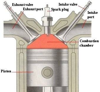

Is that like cleaning the heads and filing them down for smoother op?
Or is that like boring it?
It's a combination of honing out the intake ports and polishing them smooth. The danger is, as the head is cast aluminum, in honing (grinding) the port a void in the cast may be exposed. This happened to a friend and the head was useless for anything but a coffee table!
Ah nice, I found a picture to help me fathom.
