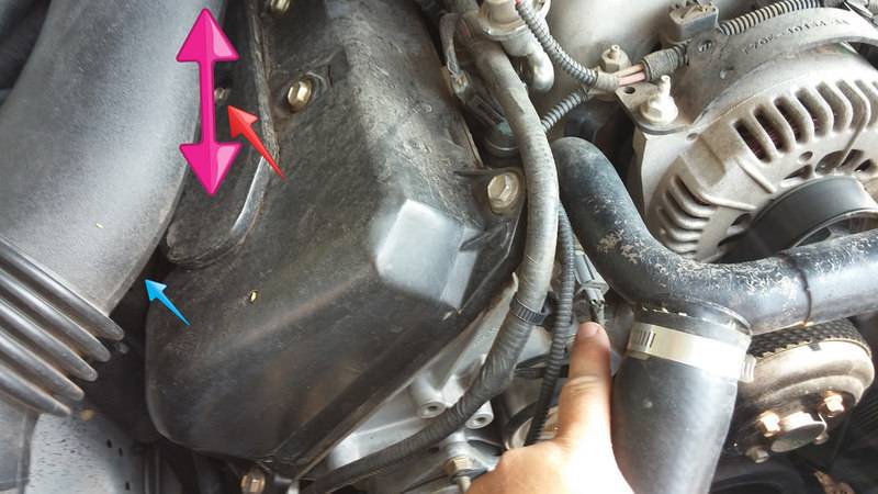

    Did you remove the cover from the middle of the cam (valve) cover? There is no actual bolt that holds down the COP, it is held in place by the cover. Sounds like your doing something with the injector maybe?
    First remove the AIR intake (zip) tube from the air filter and the throttle body (the thing that that the blue arrow points to)
    Then remove the bolts (one is pointed at by the blue arrow), holding the cover on (the cover is the thing under the pink double ended arrow)
    Then you can see all 4 COPS on that side, unplug the connector and pull it out.
