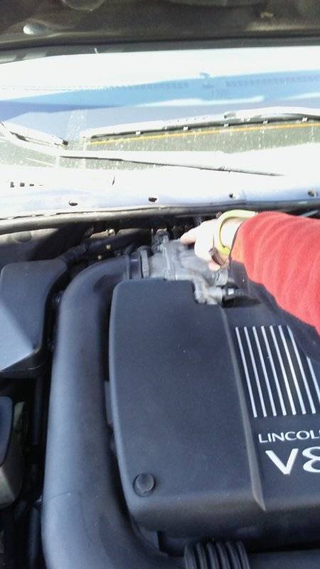

For the 2002 lincoln LS v8 3.9L The idle should be set for 750-775. There is an idle adjustment screw on top of the throttle body(close to the firewall highest point of the motor you can't miss it.i). You will know you've found the idle control bolt when you can push it and rev the engine.push hard! Then just tighten or loosen for rpm needed.or just have someone sit in the car and rev the engine and you go look under the hood at the same time and you will see it move.
Idle control bolt
WRONG!
Your instructions are going to cause problems and maybe damage!
Idle on the LS (as with just about everything else) is controlled by the PCM. On the first gen, it uses an IAC to do this. On the 2nd gen, it uses the electronic throttle. The bolt you are wanting to adjust, is the throttle hard stop. It is set very carefully using measurements of the throttle valve position at the factory. The service manual has warnings to never touch this for good reason.
If your idle is wrong, you need to fix the actual problem, rather then mask the symptom (and cause new problems) by adjusting the hard stop. It is not an idle adjustment!
