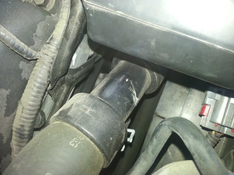

I think I found the cause of my mystery overheating!
curt941
Oct 29, 2010
29
DFW

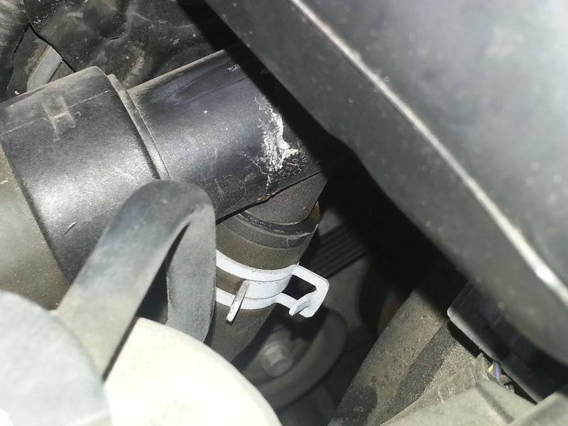

Clearly a hairline crack in the top, and it looks like it's weeping coolant at that bottom hose as well!
Now, could someone help me verify which parts I need to order to replace this connecting piece?
Also have a new degas bottle on order I'm going to install at the same time.
And lastly, anything special I should look for when picking out a coolant at the autoparts store?

Gen II doesn't really have a "cooling Tee or Tower", instead it has the dreaded coolant outlet pipe and thermostat housing. Since you problem is just the upper radiator hose, you can replace just that. However, you are very likely to find that the coolant outlet pipe, the lower radiator hose, and the degas bottle will all soon follow. I recommend that you replace all of those as well as the 4N99 part below the coolant outlet pipe.

The part that is leaking for you does resemble a sort of crooked "T" if that's what you mean. If you notice on the parts list it also has the prices I paid for them, FWIW I thought fordpartsgiant.com had very good prices and the two times I've ordered from them have been very good experiences, shipping within a day or two and at my doorstep within 4 days.

I have already had the thermostat housing replaced, it catastrophically cracked and this piece seems to have developed it's crack about a month or so later.
this is how it happens, all of the plastic engine parts have pretty much the exact same life expectancy. i started with needing to replace the coolant outlet pipe after a end cap blew off. then i found another broken piece in the thermostat housing, and by the time i was done i also noticed that the upper radiator hose was leaking in the exact same spot as yours. unless you want to have to drain the system and replace parts every month or so, do your self a favor and replace them all and do the work only once.

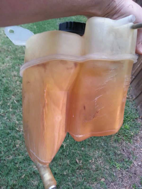

Here's a picture of the Degas bottle. This is right under 85k miles of driving in Florida and Texas

Im at 155k miles now on my 2002 V8 LSE that I bought brand new Dec 2002. I replaced my cracked degas bottle after about 3.5 years of use and at 62k miles. replaced it again 5 years later (5 years after the first replacement bottle) at 142k. Rest of my cooling system is still original parts from the factory.
