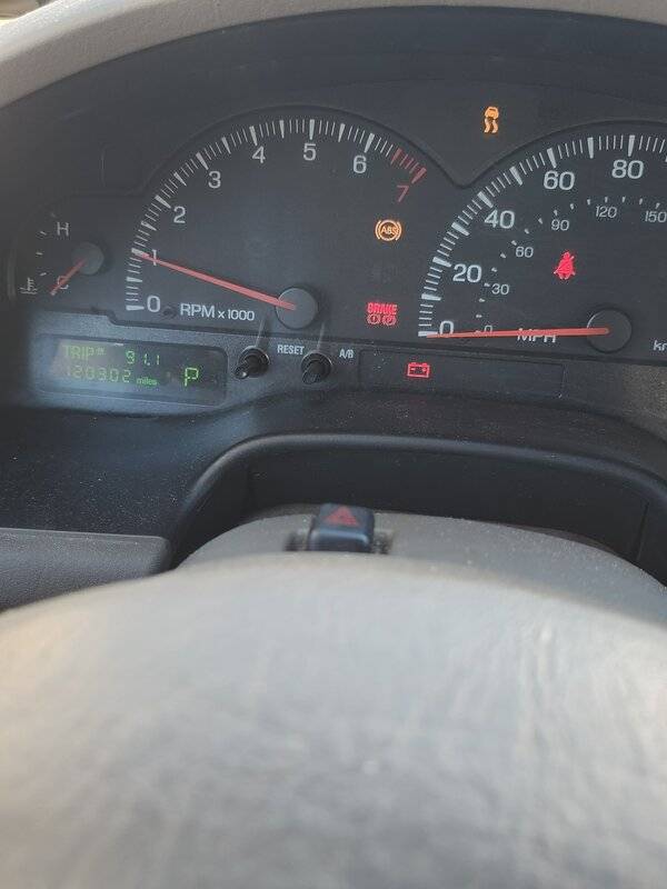

Just ran diagnostics for the HVAC Control Module and I'm getting codes 12 63 and 16 76

Called it. My alternator started giving me some trouble yesterday, 20 miles out of Orlando. So I did the thing Italian car owners do when their alternators are causing some grief, which is driving faster.
Made it to my destination and back, but she quit on me about a block away from my place.
Thankfully, I had just bought a NOCO GB40 booster pack earlier in the day and charged it before I left. Hooked it up, and it had just enough juice to get me across the block to my place.

Well, I had the alternator swapped and she runs like she was never flooded in the first place. I've confirmed that my battery drain is from a faulty AC blower fan (stays on after car is turned off, sometimes). Worst comes to worst, I'm sure I can just pull a fuse and just keep driving it.

There's more to it than that. No matter what may be wrong with the climate control, it couldn't stay on for more than thirty minutes are so after shutdown. There's also something wrong that preventing the car from sleeping. Just having the REM powered up with the SSP relays on will also run the battery down, just takes a few days.
