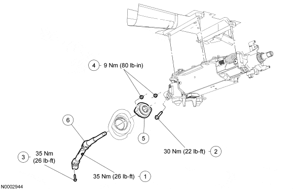

I get a periodic whine when turning the steering wheel. Not a "low on power steering fluid" whine but a high pitched one. It appears to be coming from around the "intermediate shaft bearing plate" (#5 in the picture). I sprayed some silicone lube on it and that helped a bit. Is there a way to actually grease the bearing plate?
I had a whine also. Even the slightest turn of the wheel would make noise. With the car jacked up and not running I could hear it if I turned the wheels when I was holding the tire. Figured it was the rack for sure. Anyway I bought the friction modifier and followed the TSB instructions minus completely draining the fluid by removing the lines. I just sucked out the reservoir. When I was done it was still making noise. Then I got some light weight oil and started squirting. I did the intermediate shaft u joints and the shaft where it passes through the bearing in the firewall inside and out. Afterward it still made noise. A short time later I left for work very annoyed. When I got there I noticed that it was a little better. It's been a week and a half now and I cannot hear it at all anymore. I don't know if it was the friction modifier or the oil that did the trick. If you think that the silicone lube helped a little maybe you could try light weight oil like I did.

Spray a little on the shaft the enters the steering rack at the top. Spray between the rack and the plastic cap that turns with the shaft. I've seen that top seal make noise too.
