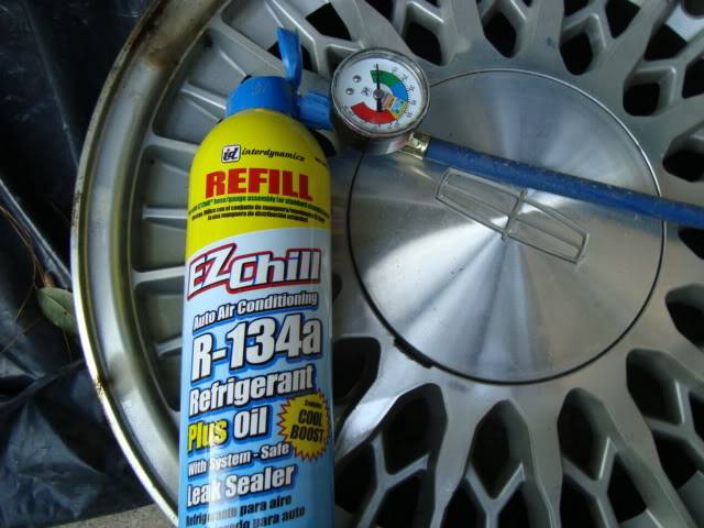

Pepp, you can do this yourself and you'll be looking at around $25.00. Go to Wal-Mart and get a can that has a gauge on it already. The name of it is EZ Chill. It has the oil, refrigerant and "system safe sealant"

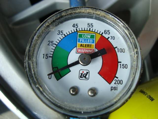

Start the car, push (Max AC), open the hood, go to the passenger side, remove the low pressure cap, shake can with hose against can or it will beat your knuckles lol. Attach the blue end to the ac port and read your pressure. You want it in the middle of the blue or to where it says 41 psi or so. It doesn't sound like you need very much added and it should stop the leak. I'll put a pic below of the stuff I'm talking about and you will maybe remember it better. O'Reilly's also has it. There are other brands that do the same but I have tried some before and the coolant just wasn't there and the leak didn't stop. EZ Chill done it for me. Just pay attention to your gauge and only add some every 5 to 10 seconds, when you know the compressor is running. If the pressure shows good, then I wouldn't add any.

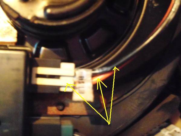

Well i had some R134a added to the system today and that didn't work i was going to do that anyway, what i did since i was at work was i txt mespock and asked what i should look for he suggested i look at the fan behind the glove box and see if a loose wire was the problem. I checked some plugs and non were loose so i nudged a couple of wires and the AC started working again and i pushed the wires back into the plug that they were in. I will post a pic of the wires i touched tomorrow it's hot outside and i am tired. Woo Hoo i have AC again. :D :D :D :D :D

As you can see two arrows point to the wires that were causing the fan not to work, i nudged them and the fan started working. I then pushed them back into the plug they were attached to and the fan has been working ever since. :D
