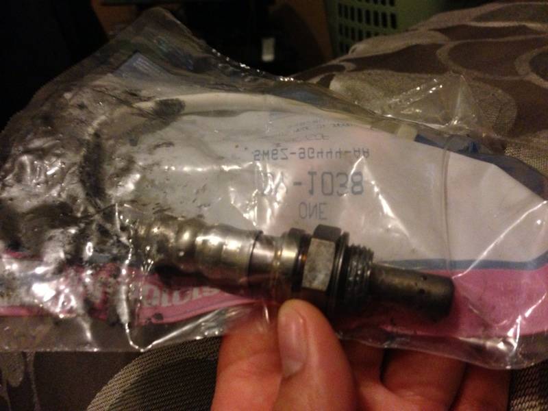

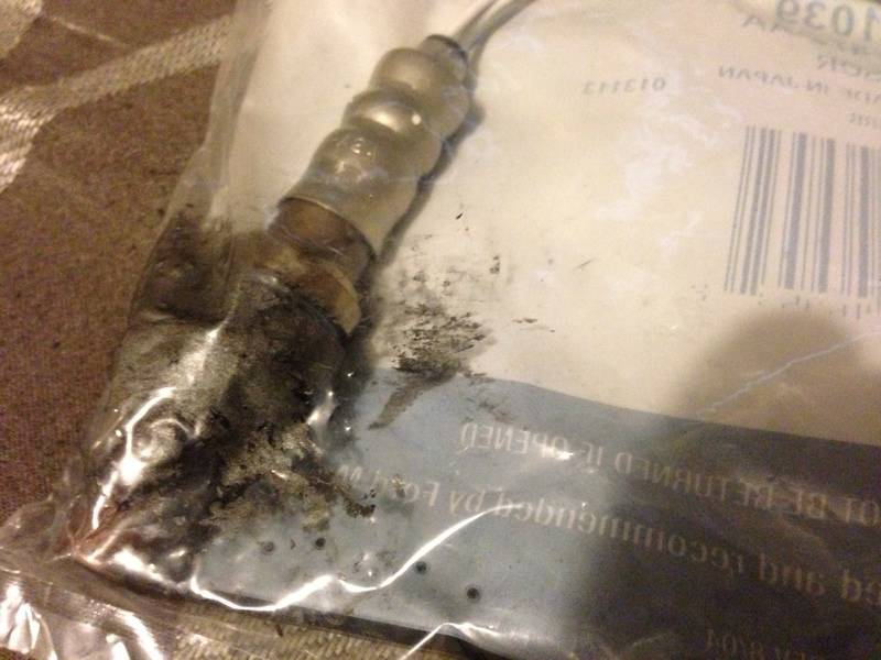

Anybody know what this black crap is? looks like it was meant to be on the threads, but with the way it was packaged its all over:
Should I clean up the stuff, and use some other anti-seize? or is the stuff on on there already the best stuff to use?
Looks like its gotten all over the sensor already, how could I go about cleaning it without causing any damage?

Anybody know what this black crap is? looks like it was meant to be on the threads, but with the way it was packaged its all over...
It looks like there is still plenty of anti-seize on the threads. I would just wipe it off the rest of the sensor and install it. They should come with a plastic cap on the end of the sensor to prevent that from happening.
