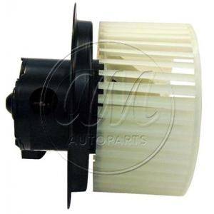

So I'm beginning to think I bought the wrong fan for the seat. I think I actually have the ac/heat blower motor instead of the seat blower motor. The pic below is what I bought. I dont think its right. Its way too big. I thought it was way smaller in the picture.

Anyway, I'm not sure but I think that the part number you list is for the whole heat/cool module, not just the blower. (That would explain the price.) Anyway, what you are looking for is a small motor with a shaft coming out each end and a small plastic fan (not squirrel cage blower) on each shaft.
Exactly, I am currently sitting in my car with the seat up and I realized the dumb mistake. I just can't figure out why it stopped working. I'm in the process of taking the motor out of the seat and seeing if there was a loose connection or something (that's what I'm hoping for).
As for the part, I think it is the entire assembly for $350 too. I don't think the tech understood exactly what I was looking for. Thanks for the fast response by the way
