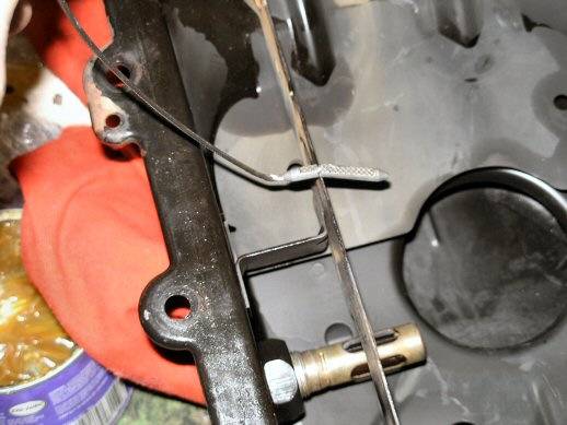

They didn't pull the dip stick out when they replaced pan, the tip of the stick will get pinched because its not guided thru the hole in the baffle of the pan. The stick is stuck between the baffle, and the crank, the pan will have to be dropped again, stick removed AND replaced because I 100% guarantee that the tip is now cracked.

Agreed, sounds like they pinched the dipstick.
Example:

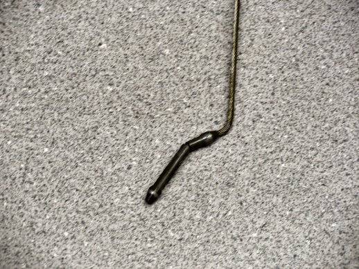

Yea so this morning I called for an update. They said they got it out but are having a hard locating another dipstick and so they cant give my car until they put it back the way it was.
