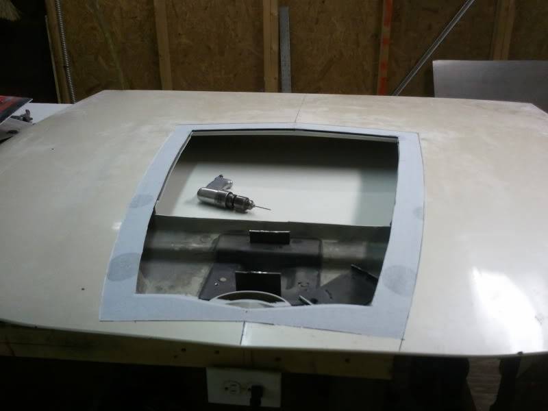

Spent the day experimenting with a hood that i got from Jamie.I cut up a GT mustang hood with the recessed intake(99 cobra).I have cut out the lincoln hood outside skin and got the mustang part to fit pretty well without cutting into the main underhood bracing.The profile is really close but I will need to slave the mustang skin a little to match the lincoln contour perfectly.I will have to modify the the bracket that acts as a outside skin support that lives on top of the hood latch plate.I will try and post some pics of this soon.It will be something different.The hood on these cars needs something.

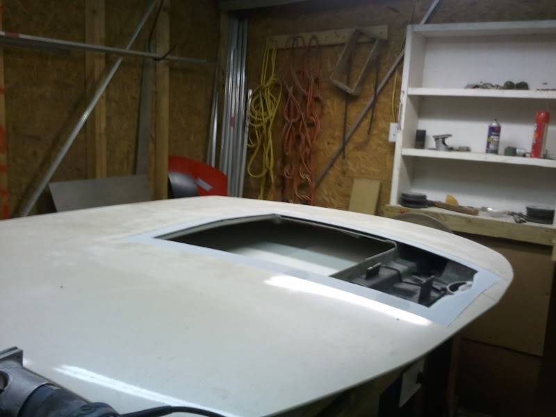

I worked on the hood more today and am running into a little problem trying to blend the front of the cobra hood with the front of the Mark 8 hood.Its a compond curve on the lincoln and a flat on the cobra.I may have needed to set the scoop area back further allowing the blend between the two pieces to happen further back.we will see.I will get somebody that can take the pictures and get them posted to this site by tomorrow so you guys can see just what the hell I'm talking about.
here are his pics so far.

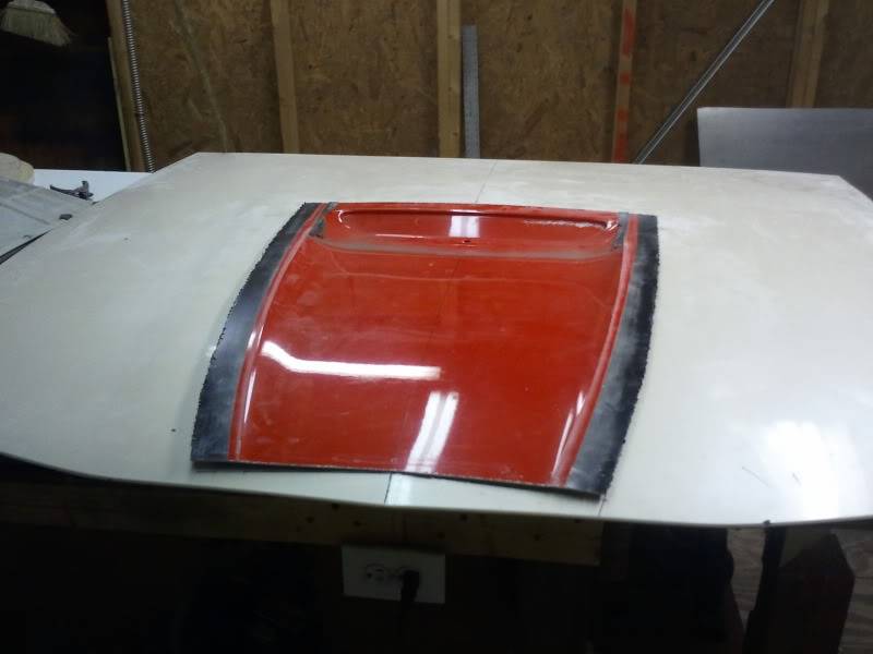

hood
I will try and get more done tomorrow.I will get a friend of mine to finish this out and paint it.More pics will follow.

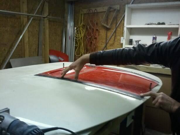

try making small pie cuts in the front of the scoop that will help with the compound curve
mod
I agree.I have grooved on the underside to crown the cobra part and that seems to help considerably.There was one more pic that showed my hands pressing down lightly on the mustang part and it followed the lincoln contour pretty well.The pie cutting is the answer to the area at the fron of the hood.We shall see.

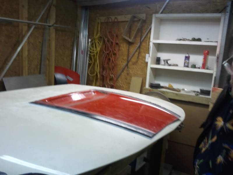

pic
Thanks for posting that pic, jamie.As you can see the profiles of both hoods are really close.I thought they may be but couldnt tell until I carved them both up.

Got it trimmed in tonight and its ready to go to the glass shop tomorrow.Its hell carrying the hoods in the back of a nissan truck but what the heck.I cant wait to see the finished product and will post pics ASAP.

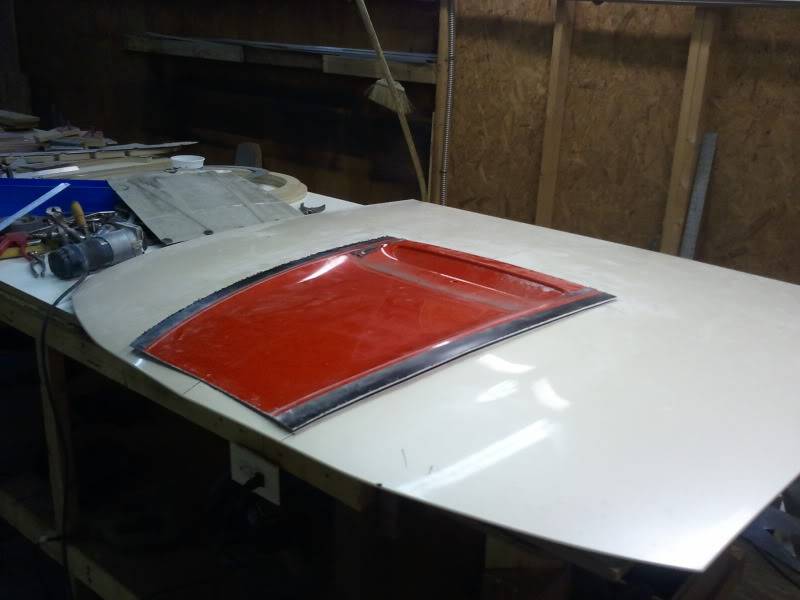

hood
I am putting in the rest of the clekos to test fit the insert and it looks pretty good.I have all the doublers in place and it has stiffened up with no warp.My car is silver and with the area of the hood matt black I think it will look pretty good.
