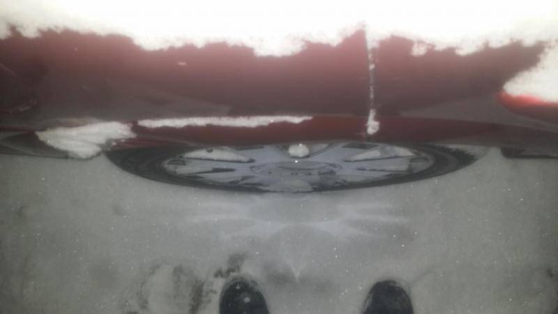

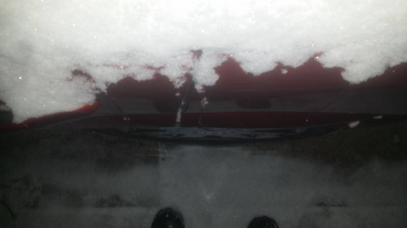

I'm gonna take a pic after work and post it, but it looks like yours for the most part. Hope it comes out well just got a crap load of snow!
I see that in the pic you purchased new toe links were you having the same issues?
Sorry for the darkness of pics, but by 5pm in Michigan in winter it night time, but the position is the wheels seem to be close to the position of your pics
That does look a bit more so than mine. It's hard to tell with the snow. We're you in dry weather when having the problem?

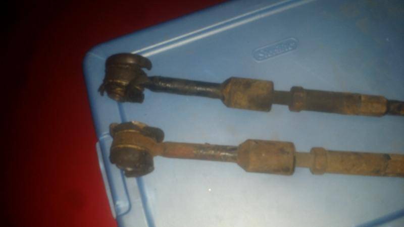

Well here are the old ones
The new ones are perfect. They took out all of the play that was in the rear end.
