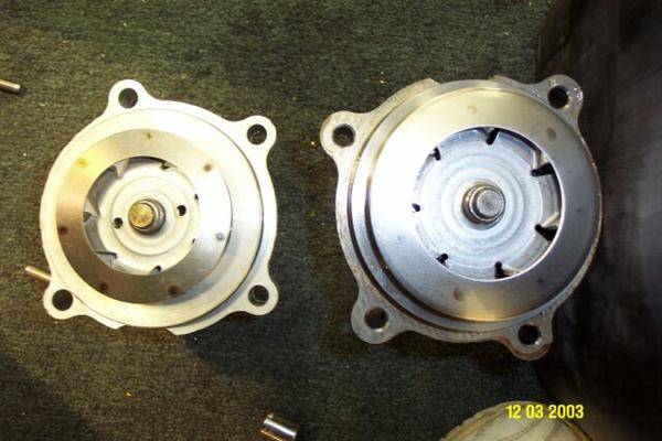

that is a sean hypeland pump, pic from their site and shows the old style exposed fin impeller that is NOT the improved design
169f'ing dollars???? wtf no way
none of the pictures i can find clearly show the improved impeller/
this was as close as i could find
if you look, you can see the impeller has a plate on the bottom of it.
reduces drag and cavitation and electrolysis and increases flow
its a cheap and effective "free mod"
